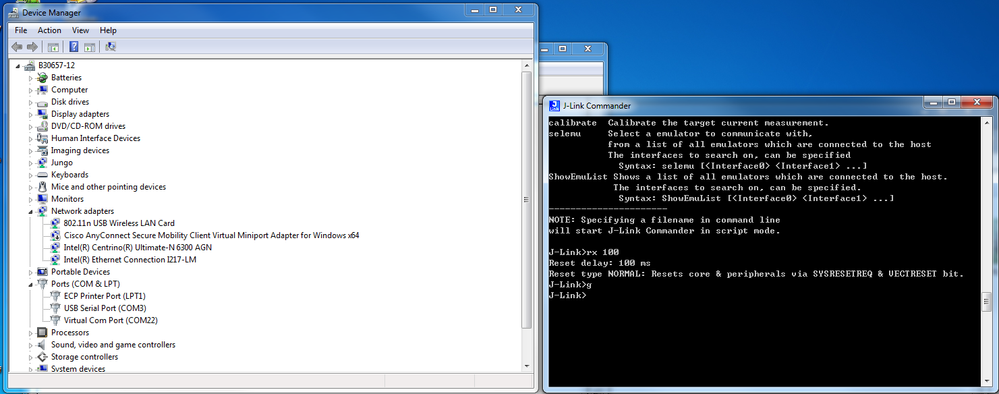

I tried to reproduce your issue based on TWR-K60N512 and TWR-SER, but failed . The following is my test process:
I powered the whole system via TWR-ELEV, and use another USB cable to connect PC Host with this CDC device, the Device Manager detected this device and set it as COM22, I could connect with this port via HyperTerminal, and this CDCdemo worked just as expected. Then I closed HyperTerminal and pressed the Reset button on TWR-K60N512, I saw COM22 dispeared while I kept pressing the Reset button, and Host recognized it as COM22 again right after I released that button, and this port worked well with HyperTerminal.

It depends on your hardware design, if based on TWR-K60N512, the reset of debug adapter is connected with MCU's reset pin, so issuing a reset command via jlink commander is same as pressing the Reset  button, but jllink would pend the MCU after reset till you issue the "go" command, actually I am not sure if you are using a jlink or something else, but with my test, the CDC demo works well even with a debug adapter attached , please kindly refer to the following for details.
would you please help to clarify how you reset the board via the debug adapter? Thanks for your patience!
Kan
