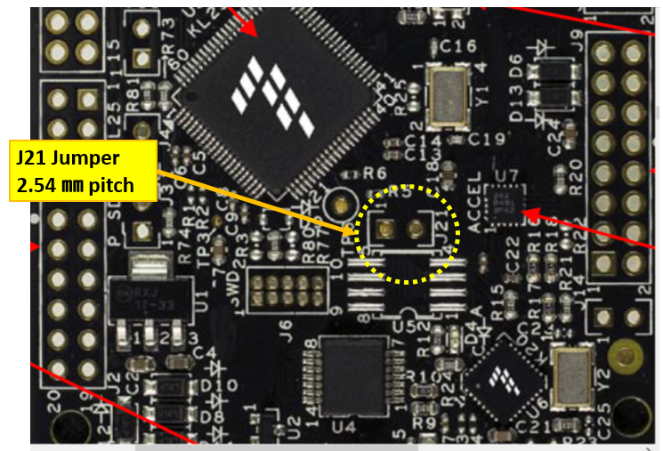

Hi, i am using kl25 series and i have configured FSL_USB_STACK for both USB_OTG and CDC. Using this configuration I have compiled and flashed into kl25 board. But after connecting USB to the device, device is not showing inside device manager.we refered below link http://mcuoneclipse.com/2012/10/07/tutorial-usb-cdc-with-the-kl25z-freedom-board/.

Hello Erich,
did you connect J21 jumper on the board?
If you already did it, I'm sorry.
Best regards.

BlackNight
there is no J21 jumper on the FRDM-KL25Z, or did I miss it?
I'm using the board with its default jumper settings/configurations.

Hello Erich,
really?
I am afraid the board had been revised.
Does your board have the below jumper?
Because no header for J21 is equipped and you should attach the header.

BlackNight
oh, I missed that jumper, sorry. So I do have this jumper *not* set.
