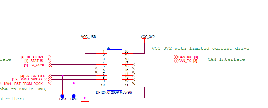

kerryzhou
Hi Niranjan,
    Your Rapid IoT Main board don't have the CAN transceiver, it just have the CAN interface:
 So, you need to connect the CAN_RX and CAN_TX to the external CAN transceiver.
You can use our TWR-SER board, that board have the CAN transceiver:
Serial (USB, Ethernet, CAN, RS232/485) Tower System Module | NXP
Wish it helps you!

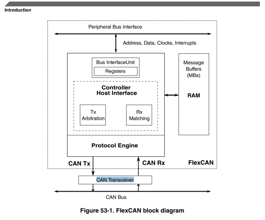

    Thank you for your reply. Yes, this would help me in my application. But I have two clarifications.
1. I am implementing CAN communication between rapid iot and a different board with distance less than 500 cm.(Only two devices will be in the CAN bus) Would I still need to add a CAN transreceiver to rapid iot?
2.I do have s32K144 board from NXP S32K144 Evaluation Board | NXP  readily available me. I looked into manual of this board and I found out this:
7,085件の閲覧回数
