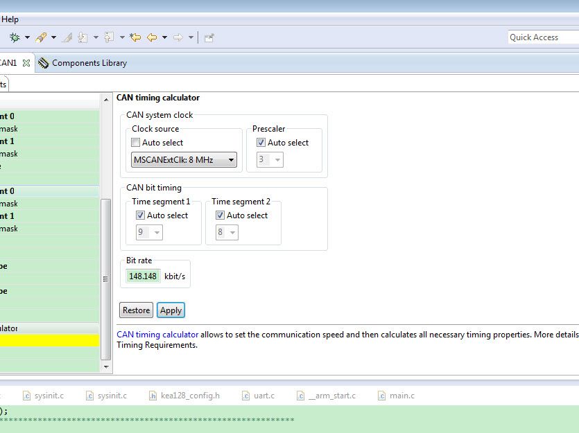

kerryzhou
Hi Eliezer Oliveira Cardoso,
     Actually, in the reference manual,  there have the calculation formula, if you want to get 150Kbit/s, and use 8Mhz as the clock source, you should follow this formula:
Bit time= (1+ Time Segment1 + Time Segment2)(1+BRP)/8Mhz
Take care:      8<= (1+ Time Segment1 + Time Segment2)<=25
So, you can configure it like this:
BPR=2
TSEG1= 9
TSEG2=8
Wish it helps you!
If you still have question, please let me know!
Jingjing

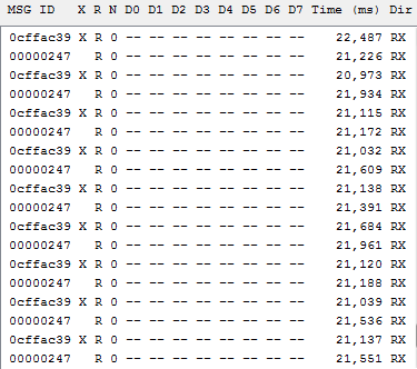

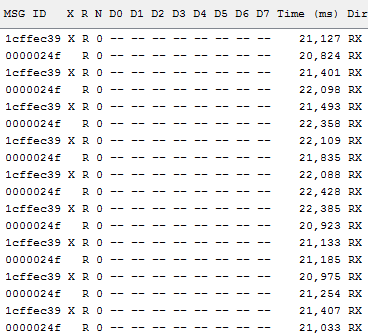

eliezeroc
Hello Jingjing.
Sorry to bother you again, it is the first time working with CAN communication.
I'm having trouble understanding the way the code was written.
To which register I should spend the calculation value of BAUD_RATE?
At startup of CAN have the following code:
sMSCANConfig.sBaudRateSetting.SJW = BAUD_RATE_SJW;
sMSCANConfig.sBaudRateSetting.BRP = BAUD_RATE_BRP;
sMSCANConfig.sBaudRateSetting.SAMP = BAUD_RATE_SAMP;
sMSCANConfig.sBaudRateSetting.TSEG1 = BAUD_RATE_TSEG1;
sMSCANConfig.sBaudRateSetting.TSEG2 = BAUD_RATE_TSEG2;
To send a messages exist, simply call the CAN_SendItemToBuffer function (mscan, & sCANTxItemInfo, & sCAN_TxBuff); ?
My message I carry for & sCANTxItemInfo?
Thank you?
4,874 Views
eliezeroc
each start time and change the value displayed.
4,874 Views
eliezeroc
Hello Jingjing.
I managed to set the baud rate, the cam is sending data.
I would like to help me find where I set the device ID and in which I write variable values from my sensor to send by CAN.
Thank you.
