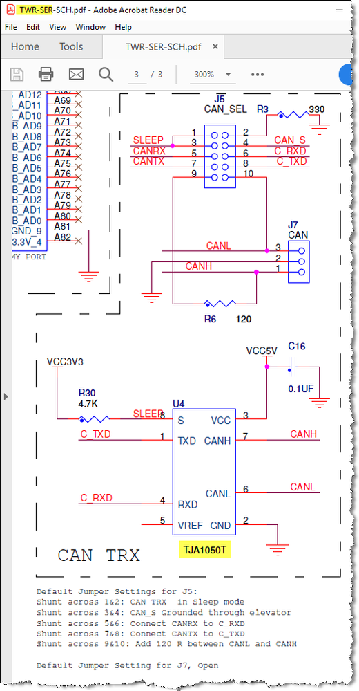

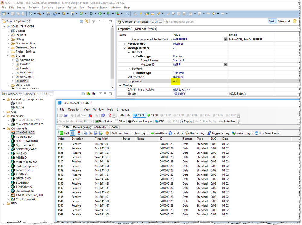

I try to flash your project into TWR-K20D72M(MK20DX256VLL7) board with TWR-SER connected.
Modify the Loop mode to no and then generated code again.
The CAN analyzer is able to receive data.
The R25 and R26 should not be DNP,  I have solder 0 resisters.
The CAN analyzer was connect to the singal output of TJA1050T(CANH and CANL).
Robin

pnaud
Thanks Robin,
I actually found that the issue was due to the Mask Filtering I had set.  Not sure why, but when I the filter is set to 0x7FF, the unit will not receive anything, even with matching Mask Filtering.  I found this out using an external CAN device, which told me I had an Acknowledgment error.  So while I was transmitting, it raised an error because it never received an ACK from anything else on the line. Everything else on the line was filtering the message out due to the masking and not responding.  I changed this to 0x00 (allow everything) and now it works fine.  I might play with some filtering later, but I can handle a simple check when I receive to make sure I got a message designated for the right device.
