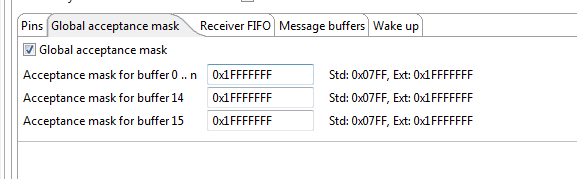

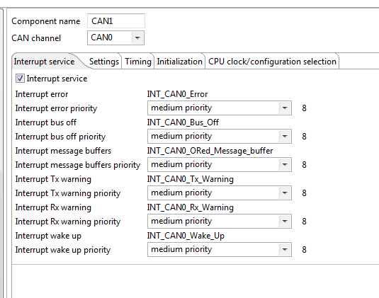

hi i've been unable to loopback any can frames. i've tried all examples here on the forum without any luck. i enabled int service. breakpoint on CAN1_OnFreeTxBuffer DOES hit, but CAN1_OnFullRxBuffer does NOT.

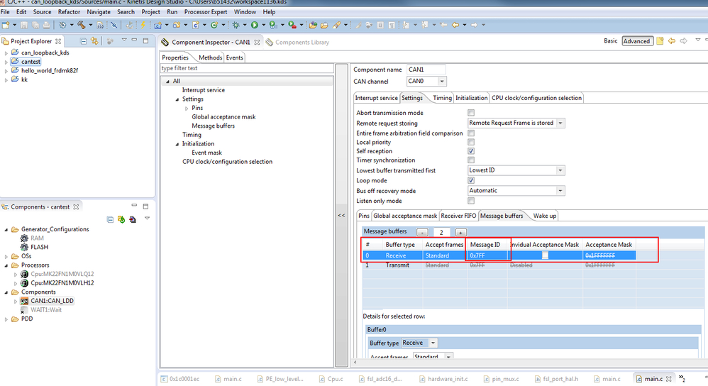

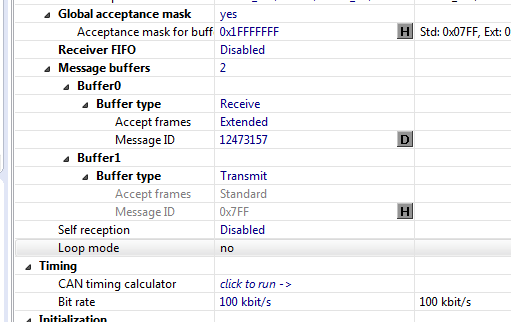

And about this "i enabled global acceptance mask of 0x1ffffff.. doesn't that mean it should accept all msgs?" ,yes ,
it can accept all msgs.
While here you configure it receive the ID 0x7ff
while in your project you writ the send can ID is 12473156, not 0x7ff.
      Frame.MessageID = (12473156 | LDD_CAN_MESSAGE_ID_EXT);

daafies
Alice,

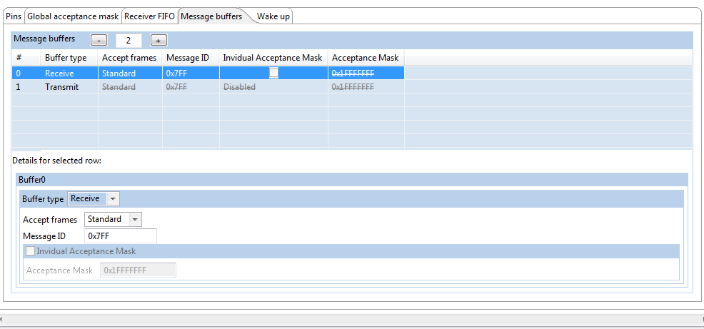

i figured it out. i had to put a messageID in the rx buffer, and send a frame with that msg id.
Confusing though cause i enabled global acceptance mask of 0x1ffffff.. doesn't that mean it should accept all msgs?

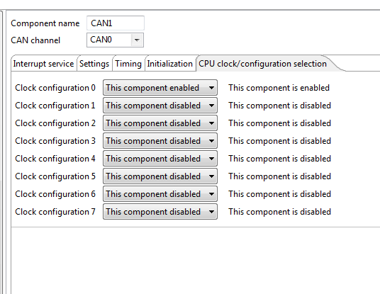

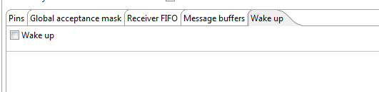

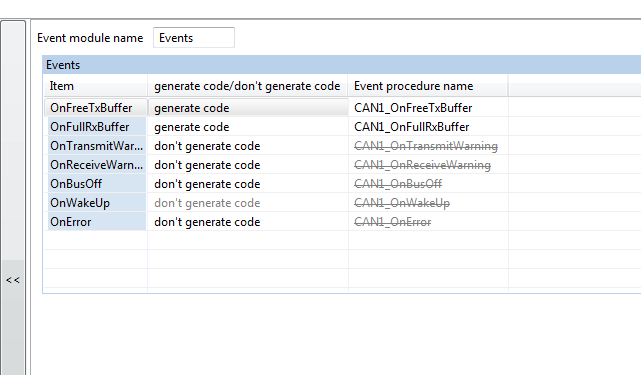

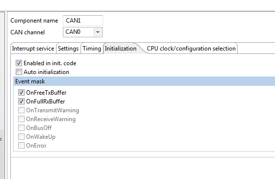

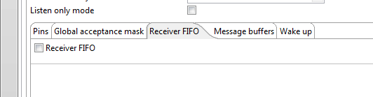

daafies
more screens i've forgotten

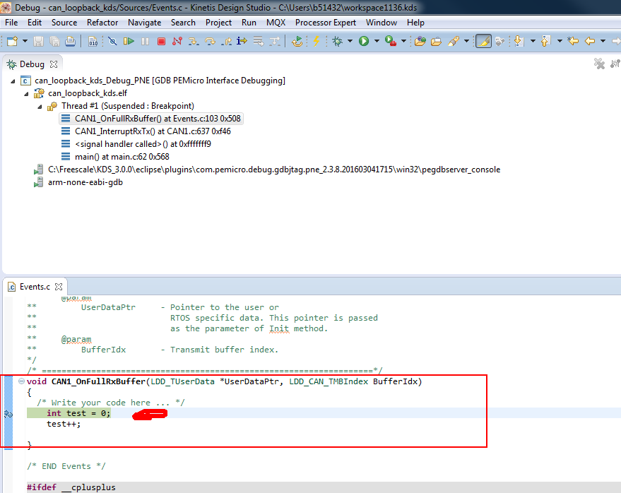

Hi david,
From the PE configuration , it seems there is no error.
Pleas test the demo code under KSDK1.3 on your board :
KSDK_1.3.0\examples\twrk21f120m\driver_examples\flexcan\flexcan_loopback\kds
Pay attention , when you download the project , please select the part number  or your chip,
and also please send your project to me , i will test it on my side the TWR-K21 board ,
i have test the demo on my board , it can run into the receive interrupt , while i have not the
chip "mk22fn1m0vlk12 " , so only need your help to test the demo , then i would be confirm
whether is the project error or the chip .
Alice

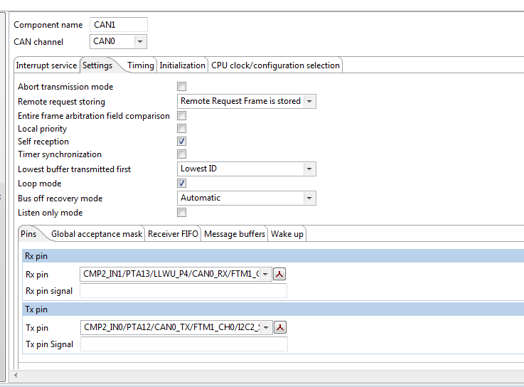

daafies
hi Alice,
yes i do use PE. and 'self reception' was set already. i've tried auto and non-auto initialization.
btw all methods called return 0x0 (ERR_OK)
here's all component inspector screens

Hello David,
From your code , it seems that you use the Processor Expert project ,
if yes, please also enalbe the "Self reception"on the CAN_LDD component :
If you do not use the PE, please set the SRXDIS to 0 to enable it on the CANx_MCR register .
