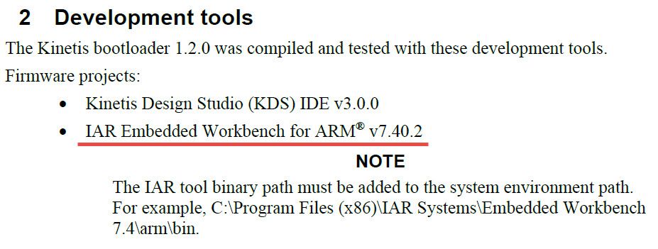

I downloaded FSL kinetis bootloader 1.2.0 and I see that bus-pal application only exists for IAR. I was wondering if anybody can share bus-pal for KDS (version 3.0.0) if they have one.

I have the new bootloader package NXP_Kinetis_Bootloader_2_0_0 downloaded and extracted on my PC.  I see the source for the busPal for IAR bus I do not see the KDS project for busPal.  Did I miss something?

Hi Doug,
The bus_pal demos have only supported the IAR IDE now, other IDE, such as KEIL, KDS will be provided in updating version.

Hi Priya,
I just got the reply from the KBOOT development team, they said that the KBOOT 2.0 would provide the bus-pal application for the MDK and KDS besides the IAR.
And the KBOOT 2.0 is planned to be released in the May.

Thanks for the update. Can you please let me know which version of IAR I should use to compile bus-pal application from KBOOT 1.2.0? I am getting compilation errors when I use IAR 6.50.

Hi Priya,
I think you need to choose the IAR 7.40 or higher instead of the IAR 6.50.
