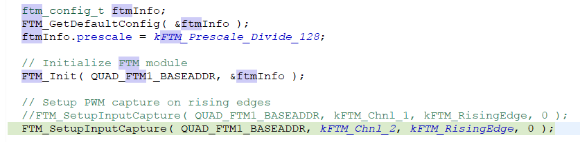

I am using the NXP libraries to configure FTM1 on an MKV46F256VLL16 - but am getting a bus fault upon calling FTM_SetupInputCapture. This appears to occur during the read to the CnSC register for channel 2. Other registers and channels of the same FTM module are not affected. FTM_SetupInputCapture is called after FTM_Init, which enables the clock gates to the module. Note that the debugger is stopped due to a bus fault at FTM_SetupInputCapture below:

Inside FTM_SetupInputCapture:

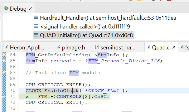

My understanding is that reads of the CnSC register should be valid as long as the clock gate for FTM1 is enabled. I have also tried enabling the clock gate as shown below, and then reading the register - which also results in the same fault. This is done with interrupts disabled to eliminate the possibility of outside interference in the time domain. Any memory protection features remain at their default settings.

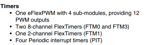

I believe I have found the problem... FTM1 channel 2 does not actually exist on this device. The datasheet shows that FTM1 has only two channels, 0 and 1:

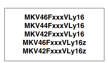

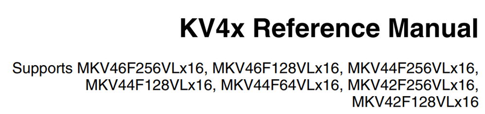

The datasheet appears to cover all parts the reference manual covers - which seems to mean that the reference manual refers to registers that don't actually exist in any of the hardware.
Datasheet:

As you mentioned, FTM1 only has 2 channels. You can see the number of channels for each FTM instance in Table 39-1. FTM Instantiations of the KV4x Reference Manual.
