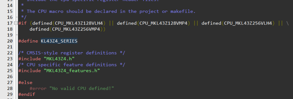

Hi, I have a code base which currently is written to support just one type of MCU. Going forward, how would I go about using the same code base (with minimal changes depending on the MCU under use) to support more than the one MCU?

You can add some #define to your project . When you change MCU , The #define will help you choose the corresponding code.
Just like the follow picture shows.
Jianyu:

@nxf58904 has a good suggestion to #ifdef check of the processor which should be put in the start of the MCU specific file so that an error is thrown if somehow the wrong MCU specific file was copied into the project.  I'll add that to my MCU specific files over time to ensure I'm not bringing in anything I don't want to accidentally (although that's somewhat unlikely because I start my MCU specific files with "SDK2_7_0..." and if I have accidentally copied in and using the wrong file, it stands out in the file list).

I'm currently doing something similar to @nxf58904 's suggestion, using the CPU_<MCU_PART_NUMBER> which is already used throughout and defined under preprocessor symbols.

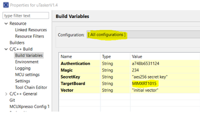

For general techniques, I have found "Build Variables" in MCUXpresso (most other IDEs have something equivalent too) useful for simplifying managing target control for a project and there is a video showing building with MCUXpresso and controlling targets using such user definable Build Variables at: https://youtu.be/p_eUGo6GypY
A document based version is at https://www.utasker.com/docs/iMX/MCUXpresso.pdf
whereby these variables (which can be added and defined to suit) are found in the Project properties, eg.
Mark
