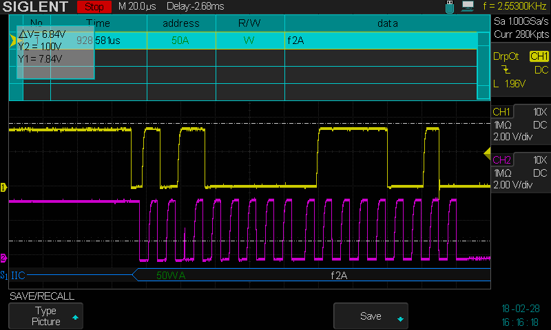

We're using a MKL17Z64VLH4 microcontroller as a I2C master to communicate with a PMBus device. When left running, the microcontroller occasionally produces glitched clock edges as can be seen below.
The glitch can be seen here in place of the 3rd SCL pulse of the transmission. By counting the rest of the pulses, we can assume that when the master transmits this glitch, it believes that it is sending a full well-formed clock pulse. Data that we’ve collected shows that this glitch can occur in place of any of the clock pulses in the address transmission.
Is it possible that these glitches could be the result of misconfiguration of the I2C peripheral? Or has anyone seen similar glitches occurring? These glitches pose a fairly serious problem for us as some of them cause the I2C slaves to get confused and to hold the bus indefinitely (this can be seen at the end of the screenshot).

The double-buffered I2C in the KL17 has a number of errata that need to be considered - see the latest errata document for latest details.
Also see appendix A of the uTasker I2C user's document which points out a few rules to respect to ensure reliability: http://www.utasker.com/docs/uTasker/uTasker_I2C.pdf
The uTasker I2C driver has been used in various industrial products using intensive I2C operation for a couple of years without any issues but you may find it necessary to modify the NXP examples to achieve reliability. I believe that NXP also advises using DMA operation to work around some time critical problems, although this was not found to be essential.

Thank you for the information, do you happen to have a link to the latest KL17 errata document? The device datasheet mentions a document called xN89M (where x is the device revision), but all I can find is 1N89M which doesn't contain any relevant i2c errata!

Unfortunately there is a not a lot in the erratas as I see eg. https://www.nxp.com/docs/en/errata/KINETIS_L_1N71K.pdf
but there are many threads about problems:
eg.
https://community.nxp.com/message/460444
https://community.nxp.com/thread/377611
and I was communicating with someone from NXP a couple of years ago responsible for some updates. Although the migration guide was changed to include a few details it looks like that they are not considered as actual chip errata.

I saw that some delays were built into the NXP drivers but without any explanation of what they were working around or whether they are needed. Delays in drivers tend to change timing slightly to maybe avoid a race state but also look to be random attempts to change some undesired behavior that may or may not work.
In fact I never saw I2C clock glitches so maybe you have something in your system that is changing the clock used by the I2C module for a short time that makes it do this (?)

Thanks again for all the detailed information! I'm afraid that I'm out of the office on Monday, but I'll review all of the information you've provided then and see if it's a fit for the problem we're seeing. As you say, there's still a suspicion that the problem that we're seeing is the result of some fault in our system, and not specifically in the microcontroller.

Would you mind to post your circuit here? And please send me your clock setting, include system clock, cpu clock, and clock mode.
