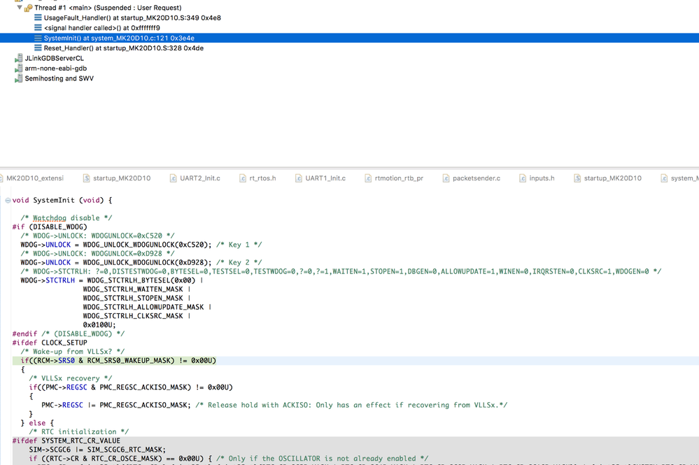

I have a new hardware revision (we are rapidly iterating prototypes).  Nothing should have changed around the microcontroller, in terms of it's oscillator, reset pull up, power supply.
I'm getting this...  i.e. a crash on the line
if((RCM->SRS0 & RCM_SRS0_WAKEUP_MASK) != 0x00U)
Is there a physical cause which could possibly be to blame...?  Or should I be looking for something that's been broken within the code/settings?  This is code auto-generated by KDS 3

Hi Kris Bird,
   Are you sure your chip is mk20dx256vlk10 not mk20dx256zvlk10?
   Because from the reference manual, you will get that mk20dx256zvlk10 don't have RCM_SRS0 register, just have MC_SRSL.
   mk20dx256vlk10 have the RCM_SRS0 register, so I think maybe your board is using mk20dx256zvlk10 not mk20dx256vlk10 , then if you use RCM_SRS0, the program will enter in the hardfaul isr .
  Then when you create the project, you should choose mk20dx256zvlk10 instead of mk20dx256vlk10 .
Wish it helps you!

epicedium
It's a mk20dx256vlk10
3,957 Views
epicedium
It looks like the PCB manufacturer has placed
mk20dx256zvlk10
instead of
mk20dx256vlk10
Could this explain the issue? I'm struggling to find information on what the Z variant is!
Kris

epicedium
It looks like it's the other way around--  The project has always been mk20dx256vlk10, but mk20dx256zvlk10 was placed on the PCB by mistake by our supplier!
Thanks for your help!
Kris

kerryzhou
Hi Kris Bird,
    mk20dx256zvlk10 is the 1.x silicon chip, mk20dx256vlk10 is the 2.x silicon chip.
   There are many difference in this two chips, more details, please refer to the application note:
http://cache.nxp.com/files/32bit/doc/app_note/AN4445.pdf?fromsite=zh-Hans&fsrch=1&sr=1&pageNum=1
Wish it helps you!
