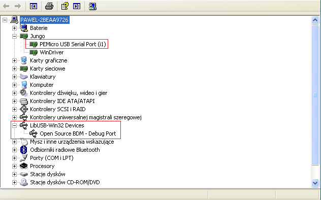

Hello! I'm using TWR-K60N512  board and I'd like to use bootloader mode. In CodeWarrior 10.6.4 I want to upload some example code and during the debuggin I get information about update.
When I put jumper on J10 the board it's undetected by computer. Any diodes light on. Earlier osbdm driver and wind driver were installed succesfully.
Please help me with this problem.

pawelniewiadoms
I also tried update by this P&E updater but it also didn't detect my board when it should be in bootloader mode. Normally my device managr detect it when there is no jumper on the J10 and it looks like this:
For the PEMicro USB Serial Port (i1) the version is 12.2.0.0 and for Debug Port version is 1.2.3.0.

kerryzhou
Hi Pawel Niewiadomski,
    The Confirm in your post means your firmware need to be updated.
  When the note happens, you should follow these steps:
1:power down your board
2:put jumper on J10
3:power on your board again and click "OK" in the Confirm windows.
  waiting for the firmware update finished.
4. power off
5, take off the jumper on J10
6 power on, click yes on the window, then you can download the code.
Wish it helps you!
If you still have question, please contact me!
Jingjing

pawelniewiadoms
I did exactly what you describe but when I disconnect my board before update and put jumper on J10 and reconnect it myc computer cannot detect the device. It's only when I'm in bootloader mode. When I click OK nothing happens and the window shows again.
