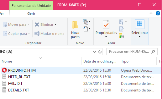

I pressed the reset button for 1s while connecting to the pc and opens the folder FRDM-K64FD (: D), I never get BOOTLOADER Drive to copy the .bin file there. I have tried it on Win10 and Win 7 and the error holds.And the reset LED stills red color.

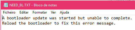

In the images below you can check the messages I get when I try to bootloader:pastedImage_3.png
So I think this happens because the bootloader driver never comes to me.

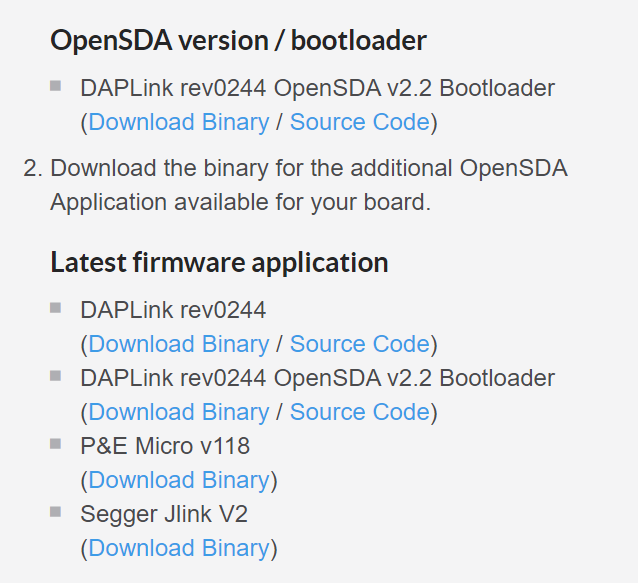

I'd like to know when you are downloading the binary file which one are you choosing for the FRDM-K64. I understand you want the DAPLink but which one are you choosing(so I can test it on my end).
If you can try again, please erase the files from the FRDM-K64 when you are in bootloader mode and drag the new binary you downloaded again. Let me know if during this process the files you described again appear during the copying of the binary.
Please let me know the results.

About the binary file I have tryed both DAPLink rev0244 and DAPLink rev0244
OpenSDA v2.2 Bootloader.

I think I never had been in bootloader mode because dont shows me a folder
said botloader to drop the files, I thonk Taht I'm always in the normal
mode in FRDM-K64F.
