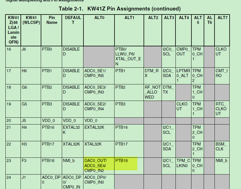

Hello Manoj Kumar,
  I have a question, do you test the SDK ADC code on your side?
  That code has been tested.
  Which detail ADC pin you want to use?
  I find you configure
   #define DEMO_ADC16_USER_CHANNEL 0
  Channel is the differential channel.
You can select a single channel to test it at first.
Your code seems the same as the SDK ADC polling code, just modify the ADC channel. I suggest you use the SDK code directly, then input the ADC voltage in PTB18 which is the ADC channel 4.
If you want to change another ADC channel, you also need to modify the pinmux.c
  PORT_SetPinMux(PORTB, PIN18_IDX, kPORT_PinDisabledOrAnalog); /* PORTB18 (pin 23) is configured as ADC0_SE4 */
Just change the related port as the ADC pin.
Wish it helps you!
