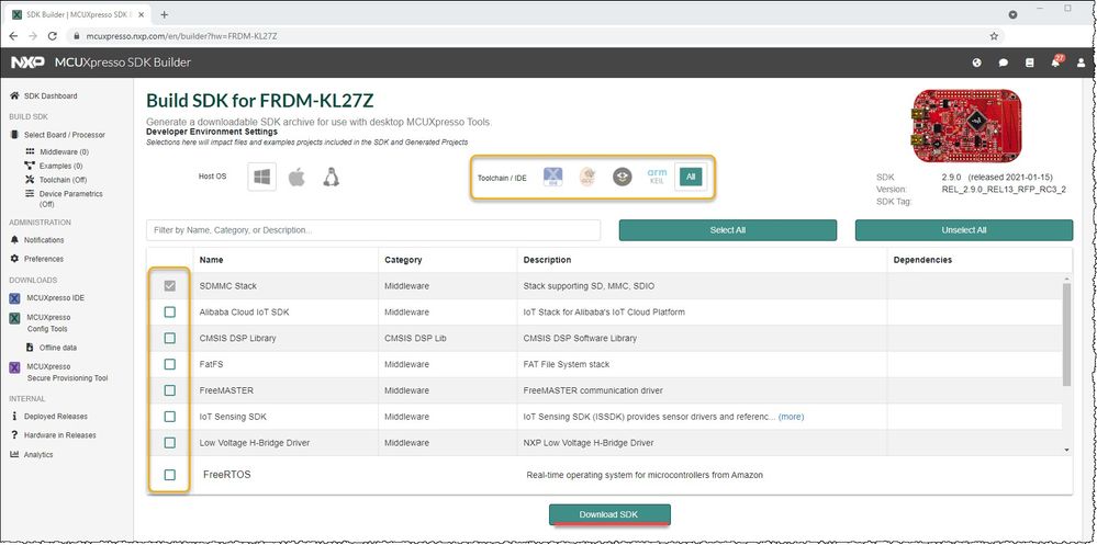

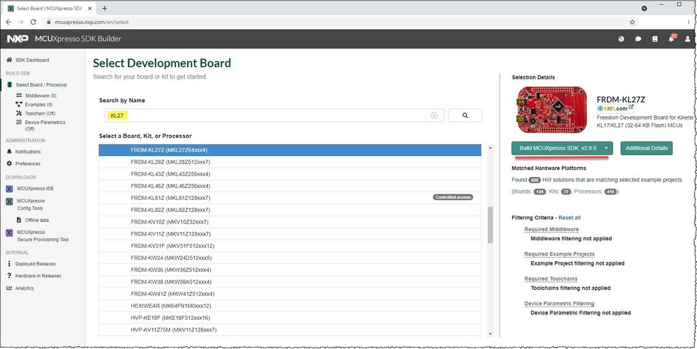

Please Select Development Board and then Build MCUXpresso SDK v2.9.0 of KL27.
Select Development Board.jpgSelect Development Board.jpgBuild SDK for FRDM-KL27Z.jpgBuild SDK for FRDM-KL27Z.jpg

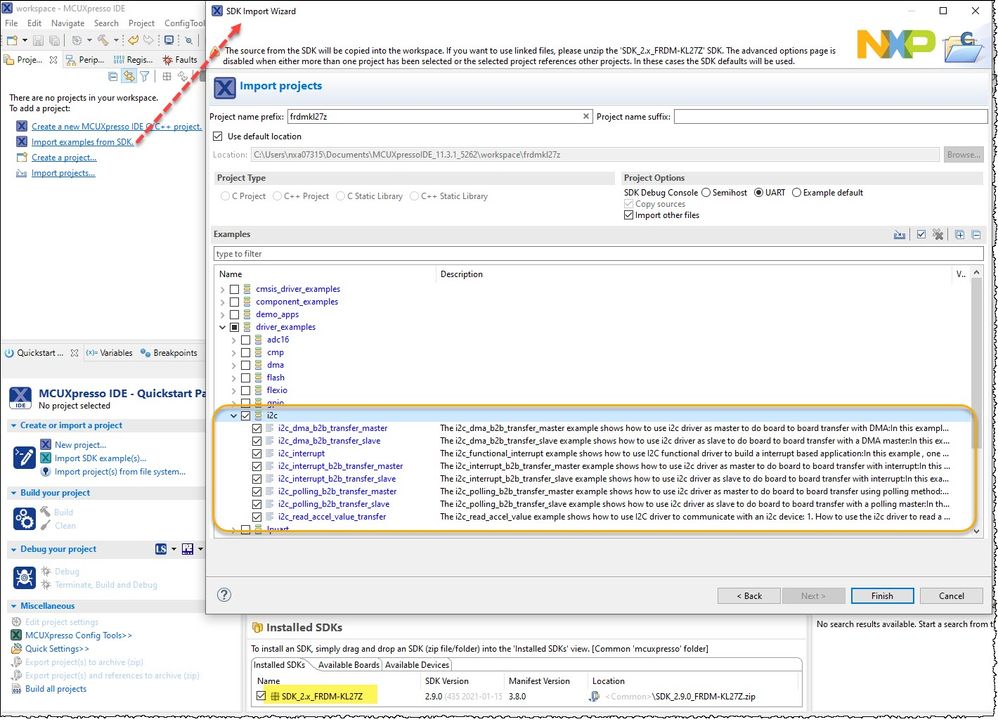

First you need to install SDK in MCUXpresso IDE, then import examples from SDK.
Here you can refer several I2C example for FRDM-KL27Z.

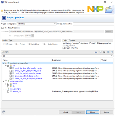

Hi @RicardoRuiz18a ,
there are examples in the SDK, just use them with the MCUXpresso IDE:
I hope this helps,
