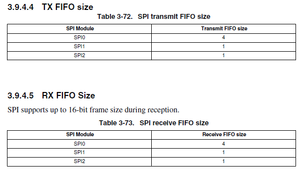

You didn't mention which SPI interface you are using.
The K64 has three SPIs - SPI0 has a FIFO of depth 4 but the others (SPI1 and SPI2) have only a single byte depth so is not compatible).
If you use SPI0 it is compatible with the DSPI in all other regular Kinetis parts.

Well that is almost certainly part of the problem - I'm using SPI1. Can you point me to what doc says that? I'm just curious because I didn't come across that anywhere. I'll rework to send a byte at a time and see if things change tomorrow.

mjbcswitzerland
Specialist V
Drew
Yes, the image went missing (this tends to happen sometimes) so I just edited it back in.

drew_k
Oh wow, I stared right at that page and missed it :smileyplain:. Embarrassing...The SPI section of the "Chip Configuration" chapter seems to be only one that provides any useful information about the peripheral it's supposedly describing! Lol. Thanks for that... Still haven't gotten around to reworking for single-byte fifo but I'll check in once I do with an update this afternoon/evening.
