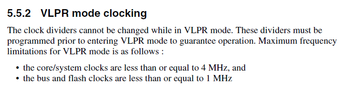

In the reference manual of the MKL15Z128CAD4R, section 5.5.2 you will find the following information.
So, before entering VLPR mode you need to configure the frequency of the clocks according to the limitations of the VLPR mode. Since the frequency you need  in VLPR mode is slower than the one you are running normally, you need to divide the frequency of the clocks. You can do this with the help of MCUXpresso Config tools.
I recommend you to take a look into the User's Guide of MCUXpresso Config Tools, chapter 4 Clocks Tool.
