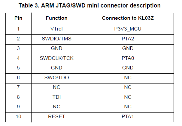

I was able to do it with the FRDM-KL03. I took some information from different webpages and did a short summary:
"For this I need:
  1. The OpenSDA Firmware with Bootloader.
  2. A 10pin ARM  Cortex JTAG SWD debug header to populate the one on the Freedom board.
  3. To cut J11 trace on the Freedom board to isolate the microcontroller from OpenSDA.
  4. A 10pin ARM Cortex JTAG SWD debug cable to connect the two boards."
From <https://mcuoneclipse.com/2013/04/21/using-the-freedom-board-as-jtag-programmer/>
I cut the the trace that connects pin 11 of the 74LVC125ADB with PTA0 of the microcontroller and with pin 1 of J6. The idea is that J6 isolates the microcontroller from the SWD_CLK signal, and use this CLK signal to program the other microcontroller. I have tested this using a second FRDM board, and an in-circuit programmer.
Have in mind the FRDM-KL03 user manual which shows the ARM JTAG/SWD mini connector description:
These are other threads that can be useful:
https://community.nxp.com/thread/308541
https://community.nxp.com/message/325654#325654
Best,
Andy
