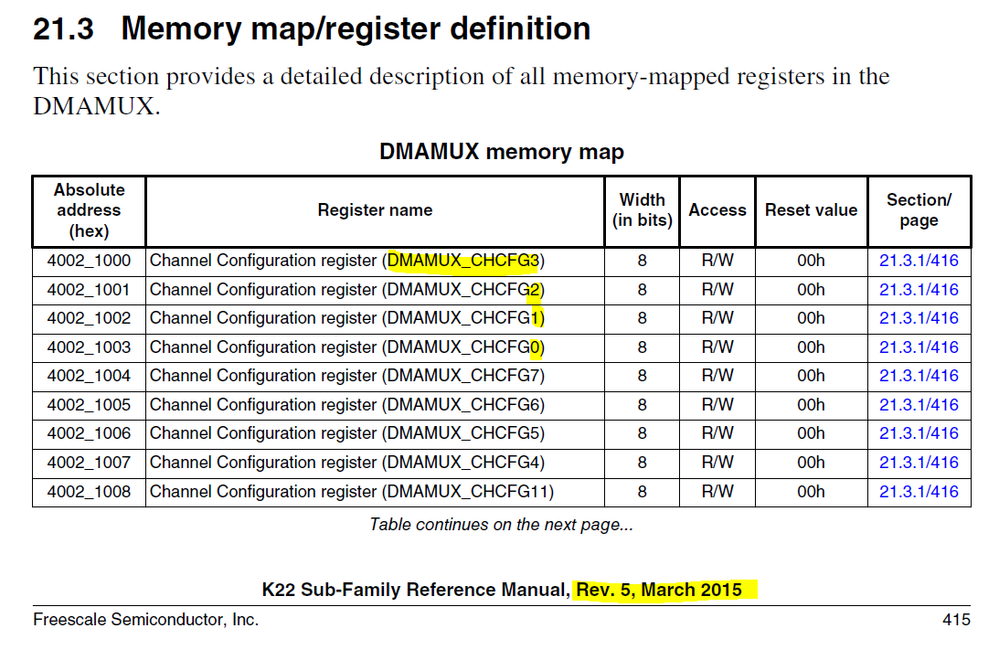

In the document, K22P144M120SF5V2RM.pdf, Rev 5 2015, in section 21.3 Memory map is listed DMA MUX channel configuration registers this shows 0x4002_1000 to channel 3, 0x4002_1001 to channel 2, etc.
An example on page 422 shows the expected mapping of 0x4002_1000 to channel 0, 0x4002_1001 to channel 1, etc.
Example eDMA code shows 0x4002_1000 map to channel 0.
Which mapping is correct?

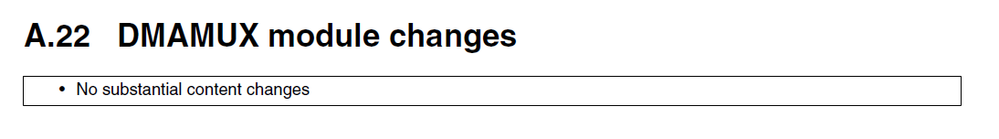

However, in the change notes:
I have always used the Rev.4 addressing for K22F product development and never had an issue, but maybe there are differences between chips since the Rev.4 is for devices called (for example) MK22FX512VLQ12 and the Rev.5 for devices called (for example) MK22FX512AVLQ12.
To be sure, try with the Rev.4 set and in case of difficulties have a go at changing the order (which I never needed to try).

In looking back at the document, the access order is correct with 'big endian' and 32-bit, I believe. However, the entire document uses character pointers, so it is confusing. There are other tables with the same 0-1-2-3 mapping to 3-2-1-0.

Hi Keith Smith,
Got confirmation from design, the memory map table in Rev 5 content is wrong, and the example code and memory map table in Rev 4 are correct. This issue was recorded in system, will update the RM when getting enough issues or 3 months later without further issue reported. Thanks!
