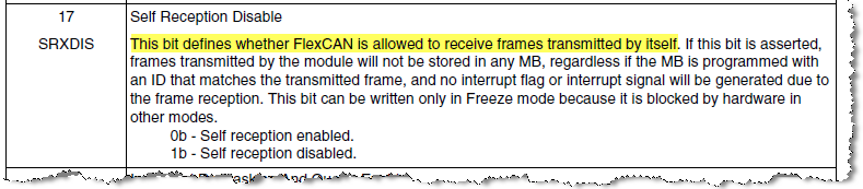

I am working with CAN interface in FRDM KW36 board. The basic functionalities of CAN( TX and RX ) is working. But whenever I send the message to the CAN is loop-backing. I disabled the loop-back configuration, but still it is loop-backing.I don'k know why its behaving like. Please help me to figure out the issue.

Hi Dileep Divakaran,
Please check the configuration of CAN_MCR[SRXDIS].
Robin

dileep_divakara
Thanks Robin Shen.
It worked. Now I am able to disable the CAN loop-back
