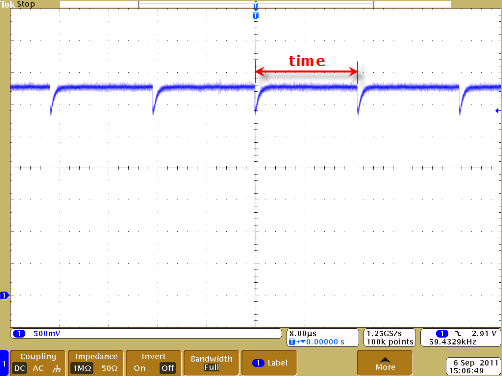

Robin_Shen
Hi Richert
I think the ADC conversion rate in k60P144M120SF3 is right, for 12-bit ADC the max conversion time is about 800ksps.
This can be calculated by using the equation in "37.4.5.5 Sample time and total conversion time" of K60P144M150SF3RM.
Also you can use ADC calculator tool to evaluate the ADC conversion rate of different configuration.
Each time the ADC sampling, you can observed voltage disturbances (voltage drops/peaks) at the ADC input.  AN4373(Cookbook for SAR ADC Measurements)
You can get the waveforms obtained by oscilloscope like below:
By measure the time between each sampling , you can get the real conversion rate.
