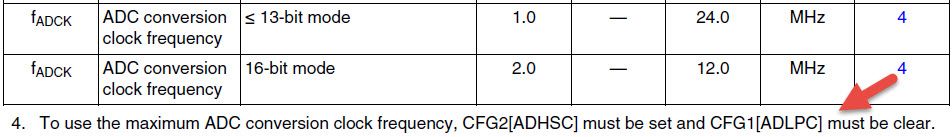

Hello everybody,
I'm working on KV31F120 microcontroller using the IDE IAR Embedded Workbench so the problem is that i want to use the ADC on its maximal clock which specified on the datasheet as 24Mhz
for frequencies under 24Mhz like 15Mhz and 12Mhz it worked very well but for the maximal frequency of 24Mhz it doesn't work.
to obtain 24Mhz i'm using the IRC48 which i divide by 2 and here is the current structure configuration of the ADC joined.
Thanks.

Hi Bilel,
According to the datasheet, the KV31F120‘ FADCK can get 24MHz as Fig 1 illustrates.
                                                                          Fig 1
So I'd like to suggest that you can share your ADC demo, then I can run it on TWRkv31F120 board and reproduce this phenomenon.
I'm looking forward to your reply.
