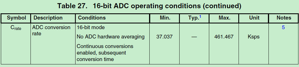

I try the code on my TWR kit k60 512. I decrease the prescaler to reduce the conversion time.
I should have more than 10K conversion per second but I can't go above 700 conversion per second.
What should be the maximum number of conversion per second  on my kit?

Hui_Ma
Please check the ADC conversion speed below:
If customer consider to use ADC interrupt mode and in interrupt service routine software trigger ADC conversion, the ADC conversion rate also need to consider the ADC ISR execute time.
There is an application note AN4590 using DMA to emulate ADC flexible scan mode and AN4590SW is the related software.
Wish it helps.

xavierbuhot1235
Where could I find these tables? I cannot find it in the reference manual.
3,652 Views
Hui_Ma
Those tables are located in K60 datasheet.
