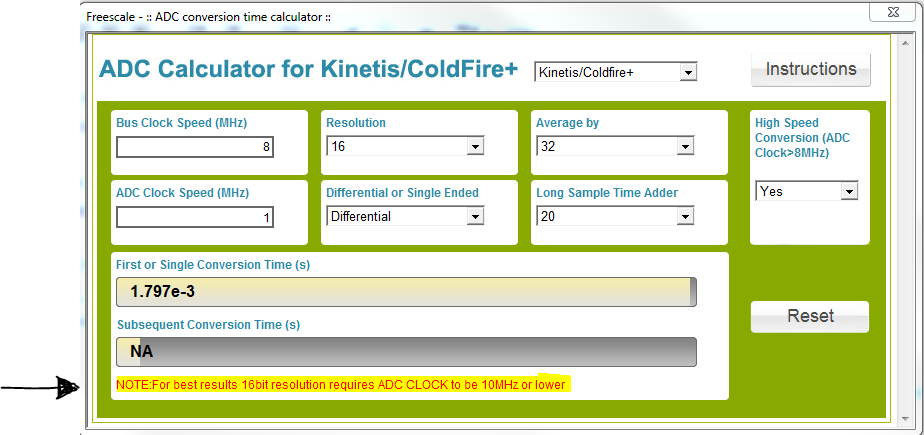

I am now getting better results compared to what I had before(1mV or less below the the measured voltage).
The reason for that is that I was using a very high ADC Clock speed.
I was using the bus frequency as an input frequency for the ADC.  ==> ADC_CFG1_ADICLK(0)
(without dividing it   :  ADC_CFG1_ADIV(0)  ==> in this way f_ADCK = f_bus = 60 Mhz )
Now I am still the using the bus frequency as an input frequency for the ADC, but I am deviding it by 8 ==> ADC_CFG1_ADICLK(3) . So f_ADCK = f_bus  / 8 = 60 Mhz / 8 = 7.5 Mhz
I fortunately found  this note in the ADC conversion time calculator software saying:
NOTE : for best results 16 Bit resoltion rquires ADC CLOCK to be 10 Mhz or lower.
I do not remember reading this note in the reference manual.

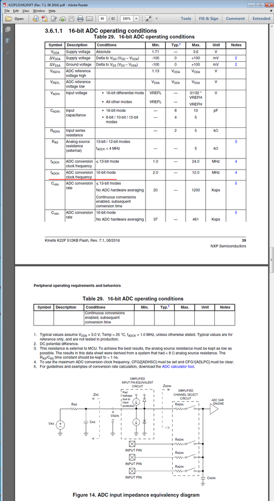

About the ADC CLOCK you can read the datasheet(K22P121M120SF7.pdf), the maximum frequency of 16bit fADCK is 12MHz.
About the ADC accuracy, I recommend you read the AN4373(Cookbook for SAR ADC Measurements):
