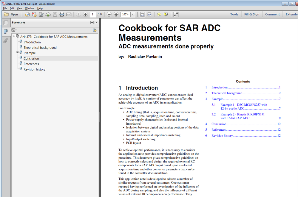

About the ADC CLOCK you can read the datasheet(K22P121M120SF7.pdf), the maximum frequency of 16bit fADCK is 12MHz.
About the ADC accuracy, I recommend you read the AN4373(Cookbook for SAR ADC Measurements):
