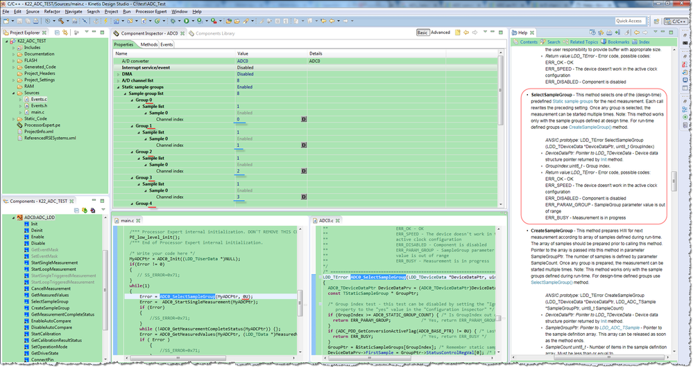

Hi Dhruv,
You can add 'Sample group list' and then set the the 'Channel index'.
Please refer the image below:

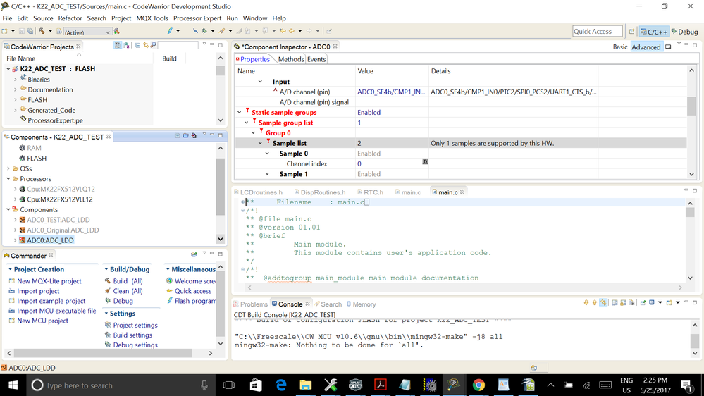

dhruvonline
Hi Robin,
Thanks for the reply.
When i increase the sample list as per the channels used in the same group, it is giving the error. Here is the screen shot. Is it required to create one 8 groups for each channel. What is the measurement sequence.  I have to read the all the 8 channels measurements at a time. Could you please suggest the modifications in the code shared.
Regard,
Druv
2,602 Views
Robin_Shen
Please test the attached project.
