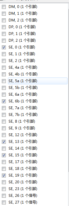

Hi there,
I can init most adc channel like the following
   ADC16_GetDefaultConfig(&adc16ConfigStruct);
   ADC16_Init(DEMO_ADC16_BASE, &adc16ConfigStruct);
   ADC16_EnableHardwareTrigger(DEMO_ADC16_BASE, false);                /* Make sure the software trigger is used. */
#if defined(FSL_FEATURE_ADC16_HAS_CALIBRATION) && FSL_FEATURE_ADC16_HAS_CALIBRATION
   if (kStatus_Success == ADC16_DoAutoCalibration(DEMO_ADC16_BASE))
        PRINTF("ADC16_DoAutoCalibration() Done.\r\n");
   else
      PRINTF("ADC16_DoAutoCalibration() Failed.\r\n");
#endif /* FSL_FEATURE_ADC16_HAS_CALIBRATION */
   adc16ChannelConfigStruct.channelNumber = DEMO_ADC16_USER_CHANNEL;
   adc16ChannelConfigStruct.enableInterruptOnConversionCompleted = false;
#if defined(FSL_FEATURE_ADC16_HAS_DIFF_MODE) && FSL_FEATURE_ADC16_HAS_DIFF_MODE
   adc16ChannelConfigStruct.enableDifferentialConversion = false;
#endif /* FSL_FEATURE_ADC16_HAS_DIFF_MODE */
but how to init the channel se4a, channel 4b,channel se5a, channel se5b etc
      how to init the channel DM0, channel DP0 etc (the same using as channel se0)
or how to init the temp sensor?
Thanks in advance!
-Jack

Hi, Jack,
I think You can call the following function in this way:
ADC16_SetChannelMuxMode(ADC0,kADC16_ChannelMuxA); or ADC16_SetChannelMuxMode(ADC0,kADC16_ChannelMuxB);
Hope it can help you.
Xiangjun Rong
void ADC16_SetChannelMuxMode(ADC_Type *base, adc16_channel_mux_mode_t mode)
    if (kADC16_ChannelMuxA == mode)
        base->CFG2 &= ~ADC_CFG2_MUXSEL_MASK;
    else /* kADC16_ChannelMuxB. */
        base->CFG2 |= ADC_CFG2_MUXSEL_MASK;
