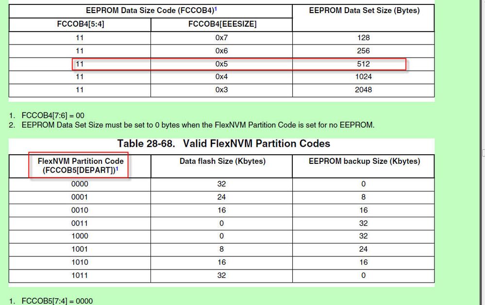

Hi Charles Lehman,
    Your code is not correct, your partition command is wrong.

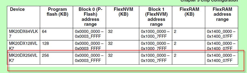

    Maybe you refer to the wrong reference manual of K20,  the reference manual of  MK20DX256VLK7 is K20P81M72SF2RM.PDF, the link is :
http://cache.freescale.com/files/32bit/doc/ref_manual/K20P81M72SF1RM.pdf?fasp=1&WT_TYPE=Reference Manuals&WT_VENDOR=FREESCALE&WT_FILE_FORMAT=pdf&WT_ASSET=Documentation Manuals&WT_VENDOR=FREESCALE&WT_FILE_FORMAT=pdf&WT_ASSET=Documentation
You can't configure FTFL_FCCOB5 =0x05, because it is not the FlexNVM partition code for K20DX256VLK7.
You can use FTFL_FCCOB5=0X02 to configure data flash size to 16KB, and eeprom backup size to 16KB.
Please change the command, and do a masserase, then run from the RAM again.

      From your SIM_FCFG1, your DEPART is 0xf, so your flexNVM is not partitationed OK,maybe your code is not correct.

Thank you! I see what I was doing wrong now, the DEPART constants I was using were from the MK20DX256ZVMC10 datasheet, not MK20DX256VLK7. The tables for DEPART are completely different between those two chips.
