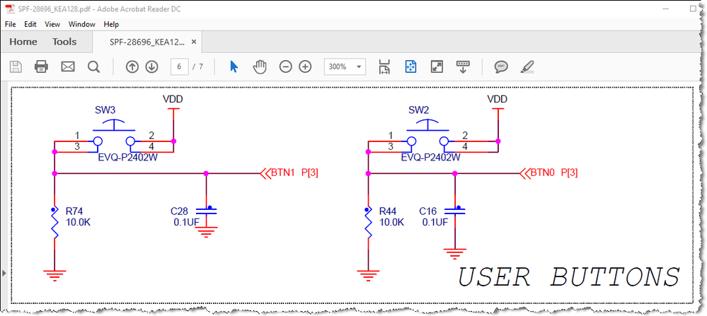

There a bug in Driver Test SW for KEAZ128->FRDM_KEA128_KBI->src->FRDM_KEA128_KBI
It should be
Besides, the annotation hasn't been updated.

Hi Li Yinwei,
Thank you for reporting this issue!
According to the KBI circuit in FRDM-KEAZ128 Schematics, KBI_RISING_EDGE_HIGH_LEVEL should be configured here.
I will contact our internal team to fix it.
Robin
