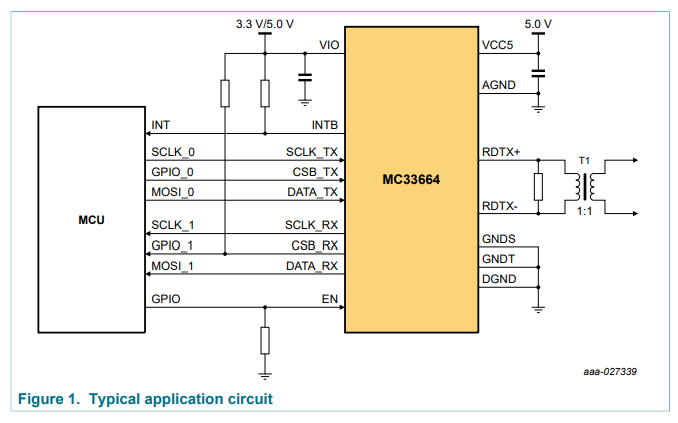

I am using an Arduino nano esp32 as a microcontroller for my 33664. The schematic is as follows:

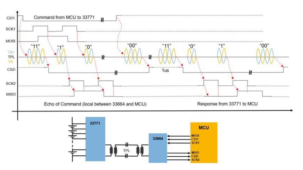

I typically use the SPI.h library for SPI communication with arduino devices, but obviously I cannot use that library in this instance as the implementation here is DUAL-SPI rather than regular SPI. I have looked into the SPI.h library itself to understand the functions so that I can write a custom driver but I am lost as to how I can implement my own functions properly. This is the implementation which I am trying to achieve:
I've read through the lengthy documentation for both of these chips but I am still empty handed as far as code implementation for the micro-controller. I would greatly appreciate any advice / insight to my issue.
Thank you

Kyle4
Thank you for the response. Do you have any software references for the microcontroller implementation? Since the MCU connects to the 33664 through dual-SPI, which connects to the 33771 through TPL, I need to know what SPI messages to send and expect back from the 33664/33771.
