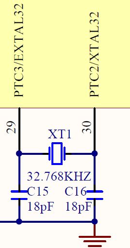

MKE18F512VLL16, the 32k crystal can't generator rtc clock.

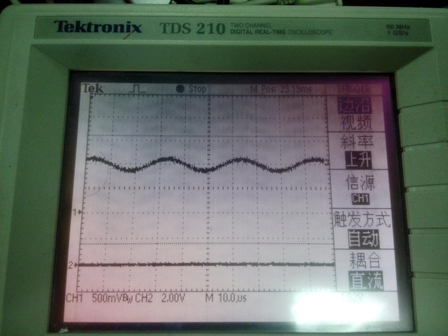

add a 1M resistance between PTC3 and PTC2, the PTC3 wave is
The PTC2 have no wave.
I had a TWR_KE18F  board,it not install the cap and resistance ,and the wave is well, why?
If  get rid of the cap and resistance in my board ,the wave frequency is 1.4M, and the amplitude is very low.

   2. About the load capacitor
    Please check your 32.768K crystal datasheet, find the proper load capacitor.
   Both PTC2 and PTC3 should have the 32K oscillating wave.
   TWR-KE18F board didn't add the external capacitor, it should be the board layout parasitic capacitance is enough for the oscillating.

 Hello Kerry Zhou:
      After change 32k SPXO, the RTC work normal.
      So the 8M and 32k crystal all change SPXO.
