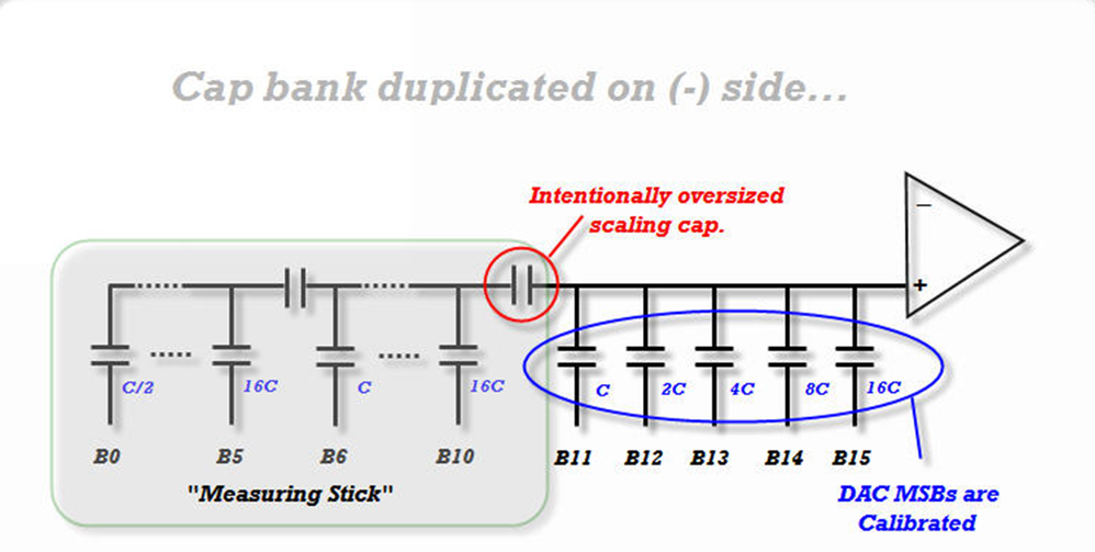

The DAC is architected with three sets of binary weighted capacitors arrayed in banks, as in Figure 1. The capacitors that represent the most significant bits of the SAR (B15:B11) are connected directly to the inputs of the comparator. The next bank of five capacitors (B10:B6) is connected to the top plate of the MSB array through an intentionally oversized scaling capacitor. The final six capacitors that makeup the least significant bits of the SAR (B5:B0) are correspondingly connected to the top plate of the middle bank of capacitors through another scaling capacitor.
Figure 1. Arrangement of DAC capacitors
Only the MSB capacitor bank is calibrated. Because the first scaling capacitor is intentionally oversized, each of the non-calibrated MSB capacitors will have an effective capacitance too small to yield accurate results. However, because they are always too small, we can measure the amount oferror that each of those capacitors would cause individually, and add that back in to the result.

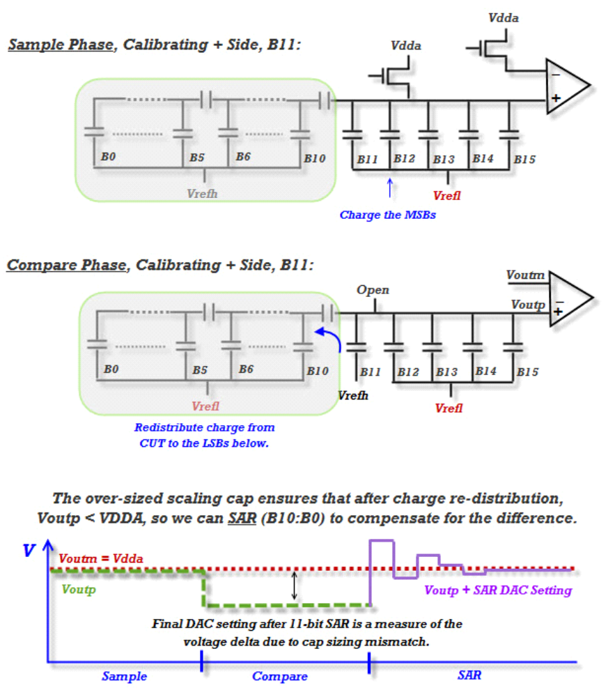

Calibration starts with the smallest of the LSB capacitors, B11. The SAR samples Vrefl on all of the capacitors that are lower-than or equal-to the capacitor under test (CUT), while connecting all of the smaller capacitors to Vrefh. The top plate of all of the MSB capacitors is held at VDDA while this happens. After the sampling phase is complete, the top plates of the MSB capacitors are allowed to float, and the bottom plates of the MSBs not under test are connected to Vrefl. This allows charge to redistribute from the CUT to the smaller capacitors. Finally, an 11 bit SAR algorithm (corresponding with the 11 capacitors that are smaller than the MSB array) is performed which produces a result that indicates the amount of error that the CUT has compared to an ideally sized capacitor. This process is repeated for each of the five MSBs on both the plus side and minus side DACs and the five error values that are reported correspond to the five MSBs accordingly. All of these error values are about the same magnitude, with a unit of 16-bit LSBs. See Figure 2 for an example.
7992_7992.pngFigure_2.pngFigure 2. Example of calibration on bit 11
