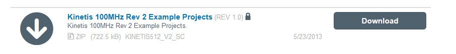

And you can also refer to the K60 spi demo to configure , for example the KINETIS_V2_SC , there is a spi demo of IAR :
Kinetis K60 100 MHz MCU Tower System Module|Freescale
If it still can not work ,you can describe it in detail .
