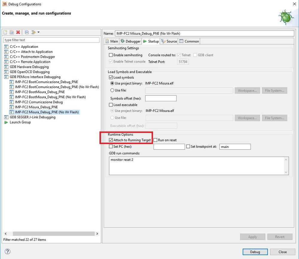

Hi to all, I'm using KDS 3.2.0, SDK 1.3.0 and P&E Multilink on a proprietary K64 board.
There is no problem at all to debug if I burn the flash: everything's OK.
I've got a problem into "attach" mode:
It correctly attach to my application (still running) and I can pause it, see registers, memory and so on,
but when I try to step and/or "run" the system very often jump to some kind of exception. It breaks into this endless loop:
DefaultISR: b DefaultISR
Of course the watch-dog is disabled.... and there isn't any external reset.
In the attach mode also the "restart button" doesn't work at all: it doesn't change the PC. Please note that it works correctly when I debug burning the flash !!!
Any suggestion ?

3,114件の閲覧回数
Salva
here you are. Thanks

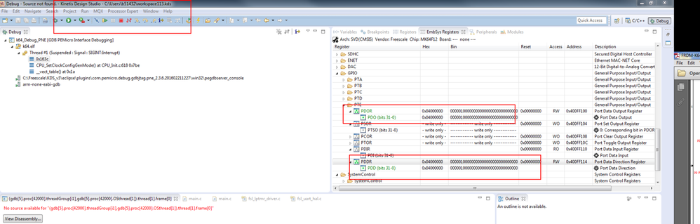

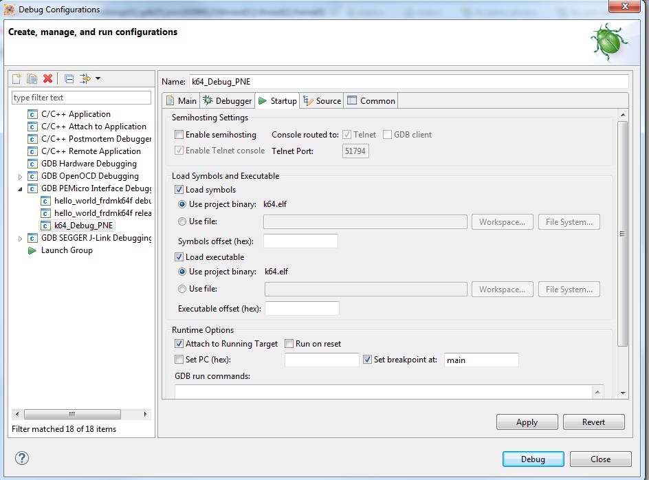

Hello Salvatore,
I test it on my side , it can work well.First i install the GPIO demo under KSDK1.3 : KSDK_1.3.0\examples\frdmk64f\driver_examples\gpio ,
then  run it , then create one simple project about k64 , then attach it as this :
after it , the LED is also can light , also can check the register on KDS:
Hope it helps
Alice
