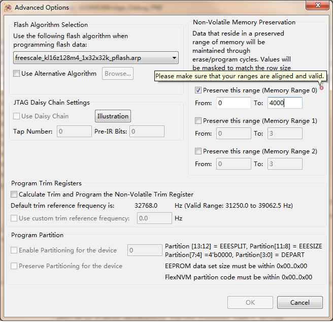

I have the problem to preserved memory range in KDS 3.0. My system is win7 (32bits).
As I debug the my app with bootloader using KL16Z, I need to preserved memory range for bootloader. When I used Advance Options in debug configuration, the field for Preserve is only accept for 0 to 3, if I put 0 to 4000 there is error sign on the upright and OK button will change into grey. Is there any setting before to use this options?
Here is the Advance option page:
Thanks.
Robert

Hi Zong,
the memory ranges are *inclusive*.
So change the 4000
to 3FFF.
I hope this helps,
Erich

zhongshen
Hi Erich,
You are right. Thanks.
Robert
