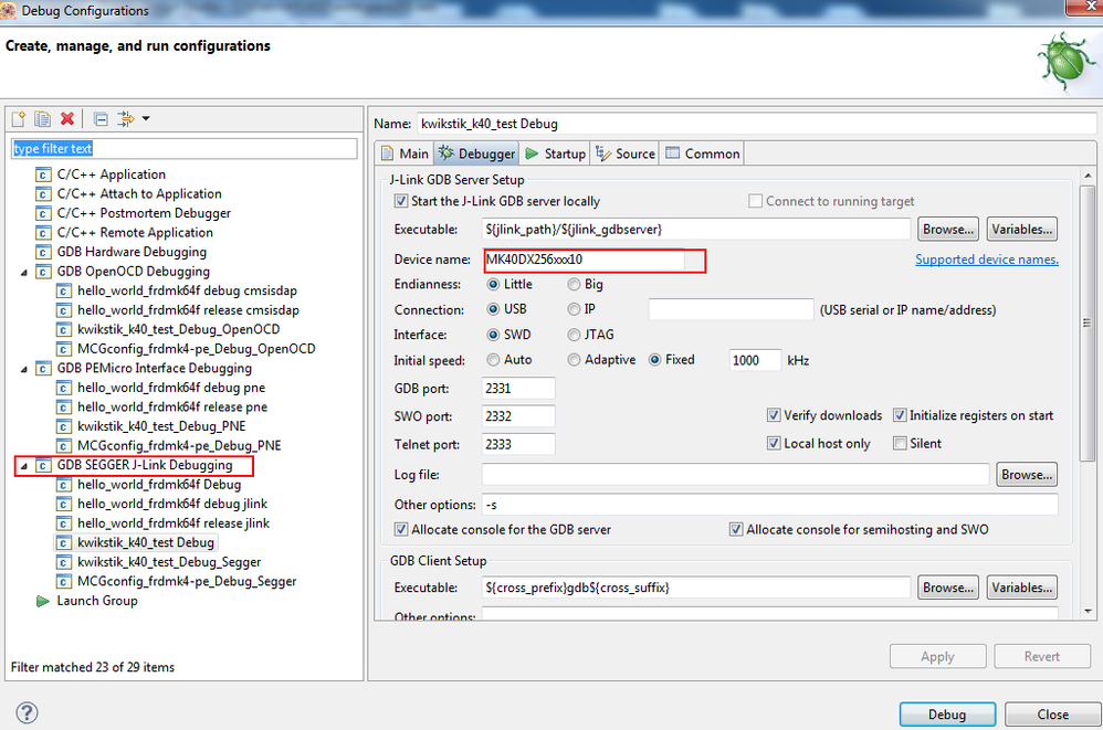

Hi  Lijo,
I recommend  you firstly create a simple project , then build and debug.
And be sure the debug configration is correct :
if it still can't debug, you can send your project to me , i will test on my side.
Alice

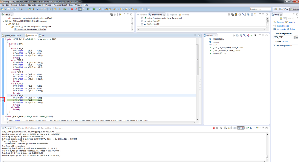

I attached some response from our IDE after flash

Hi LIjo,
After I check your "start_2" project ,  I only change here :
then , i can debug and run .  It work well .
So , your project has no  problem .
Some suggestion :
1) Please Link this USB  on board
2) only set one breakpoint like me .
Look at whether it can stop at the breakpoint.
Alice

lijofrancis
Dear Sir
The debugging mode is working .But I cant RUN and flash.may be some setting problem or not I don’t know.The error is that Lauching test_2 debug has encountered problem
Details
Error starting process.
Cannot run program "F:\hart\workspace\test_2\Debug\test_2.elf": Launching failed
