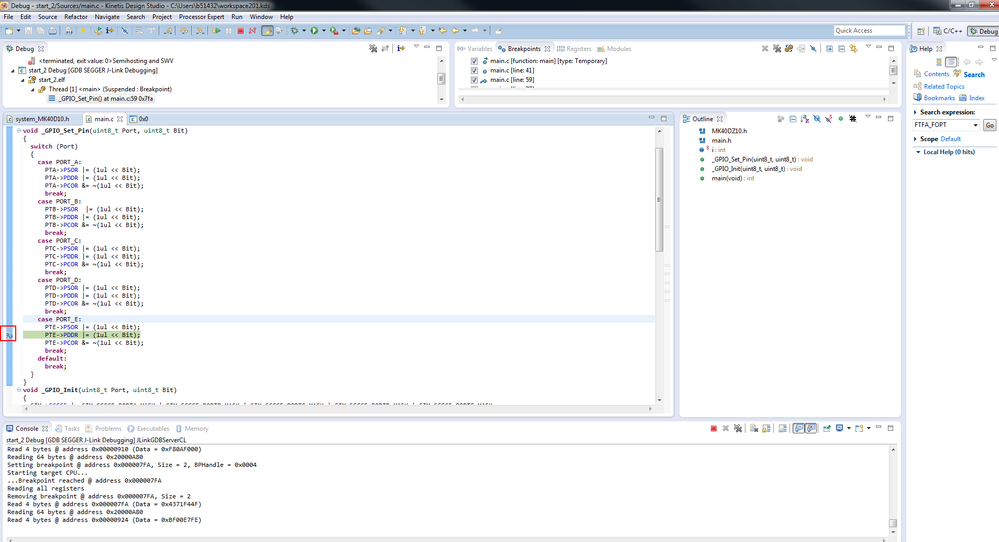

Hi LIjo,
After I check your "start_2" project ,  I only change here :
then , i can debug and run .  It work well .
So , your project has no  problem .
Some suggestion :
1) Please Link this USB  on board
2) only set one breakpoint like me .
Look at whether it can stop at the breakpoint.
Alice

lijofrancis
Dear Sir
The debugging mode is working .But I cant RUN and flash.may be some setting problem or not I don’t know.The error is that Lauching test_2 debug has encountered problem
