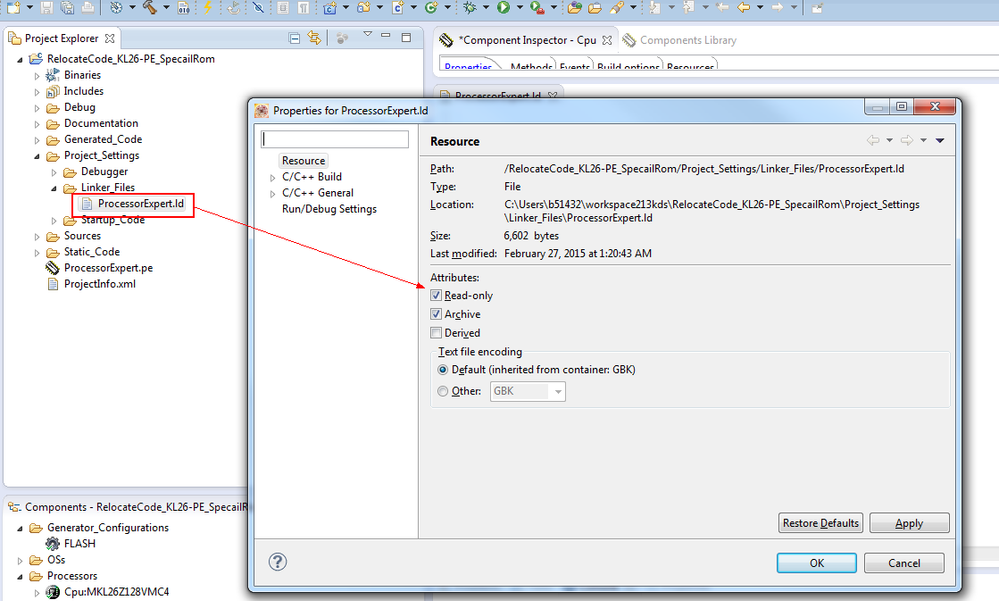

I use KDS2.0, kl26z128vlh4 mcu, create a PE project , recofiguration the "Processor Expert.ld" file , build .debug, it can work well.
Then i save it to other place, then copy it under my kds workspace ,open it . build , while , when debug, the "Processor Expert.ld" file changed,
i'm sure i select the "read-only" configuration of the "Processor Expert.ld" file .
Please see the screenshot,  and tell me how should i do to enable the file do not changed .

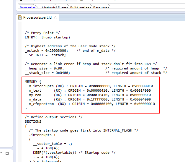

before debug , it like this :
after debug , it like this :
I configurate the file to "read only" :

"read only" properties can't disable prm file be overwritten.
uncheck "generate linker file" for it.
