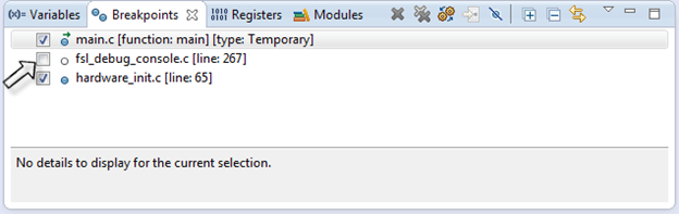

In order to disable breakpoints in KDS you need to go to the Breakpoints view on the Debug perspective:
Once there, you can disable the breakpoints by deselecting them:

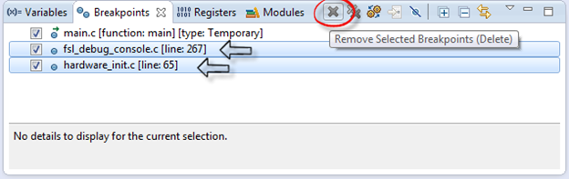

Or you can delete the selected breakpoints by clicking on the X icon:
