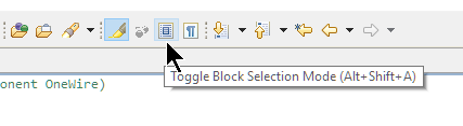

in other words how do i highlight  a block of text?
int array[5][5] = { 0, 1, 2, 3 ,4 },
                          { 0, 1, 2, 3 ,4 },
                          { 0, 1, 2, 3 ,4 },
                          { 0, 1, 2, 3 ,4 },
                          { 0, 1, 2, 3 ,4 } };
how would I highlight all of the numbers in the backates without highlighting the barckets themselves?
I an do this in other ide variants of eclipse as well as ms word. how do I configure kinetis to do allow this?
1,437 Views
BlackNight
Hi Jace,
use the block selection:
Then you can select any block of text:
I hope this helps,
Erich
