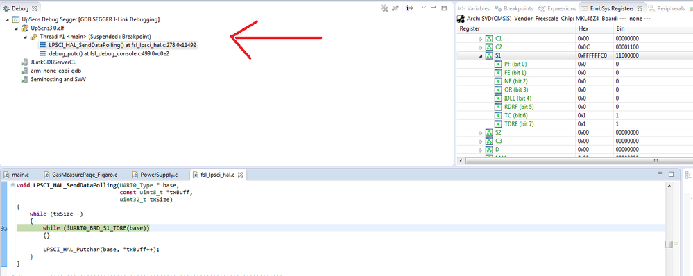

i'm using a kl46 with kds 3.1 and the sdk 1.3. I have a problem with this function where i change the frequency of my cpu according with some flag:
void CPU_Clock_Setting(void) {   int i = 0;   byte error = 0;     DisableInterrupts;   if (flag_lcd || flag_usb) {//se LCD on o USB inserita vado alla max freq   error = CLOCK_SYS_UpdateConfiguration(0, kClockManagerPolicyForcible);   i = CLOCK_SYS_GetCoreClockFreq(); #ifdef DEBUG   LPSCI_HAL_SetBaudRate(UART0_BASE_PTR, i, 115200); #endif   I2C0_SetClockConfiguration();   ADC_SetClockConfiguration();   } else{//altrimenti scendo alla configurazione di risparmio   error = CLOCK_SYS_UpdateConfiguration(1, kClockManagerPolicyForcible);   i = CLOCK_SYS_GetCoreClockFreq(); #ifdef DEBUG   LPSCI_HAL_SetBaudRate(UART0_BASE_PTR, i, 115200); #endif   I2C0_SetClockConfiguration();   ADC_SetClockConfiguration();   }   EnableInterrupts; }
the problem is when the function CLOCK_SYS_UpdateConfiguration is called, when the fsl_debug enter in the function
void LPSCI_HAL_SendDataPolling(UART0_Type * base,                                const uint8_t *txBuff,                                uint32_t txSize) {     while (txSize--)     {         while (!UART0_BRD_S1_TDRE(base))         {}           LPSCI_HAL_Putchar(base, *txBuff++);     } }
it remain in the while loop. why this? i have add the function LPSCI_HAL_SetBaudRate for  re-set the clock of the UART but same problem. Thanks

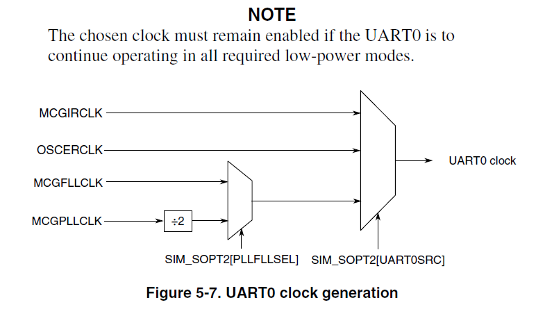

Hello Daniele,
The clock source of the UART0 not the CPU core clock , so there is some error :
And about configure the clock and the baud rate , i recommend you refer to the demo code under KSDK1.3:
\KSDK_1.3.0\examples\frdmkl46z\driver_examples\lpsci\lpsci_blocking\kds
in the initialize function , you can hwo to configure the clock source of UART and the baud rate :

36,252 Views
Hello Daniele,
From your screenshot, i see the TDRE bit has set to 1, so i think it can jump to the loop
Could you please test the demo code under KSDK1.3 on your board :
KSDK_1.3.0\examples\frdmkl46z\driver_examples\lpsci\lpsci_polling\kds

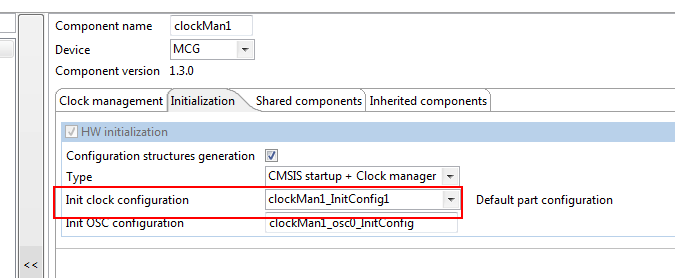

Hello Daniele,
For the component of "fsl_debug_console" use the UART, so , in order to
analysis easily , i create one new project on ksdk1.3 about the frdm-kl46(kl46z256),
add the fsl_lpsci component , also configure it to UART0 , pay attention , i configure
the PTA1 PTA2 as the  UART0 pins.Set two clock mode , FEI and PEE,
use the "clock configuration1"(PEE) mode as the
initialize mode , then change it to FEI.
In the main function , first send "abc", after change the clock mode , send "def", also can check the
current core clock :   syt_test = CLOCK_SYS_GetCoreClockFreq();
Please test it on your side , maybe you need change the Pins of UART .
Hope it helps
Alice

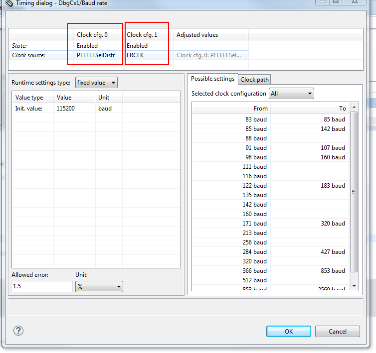

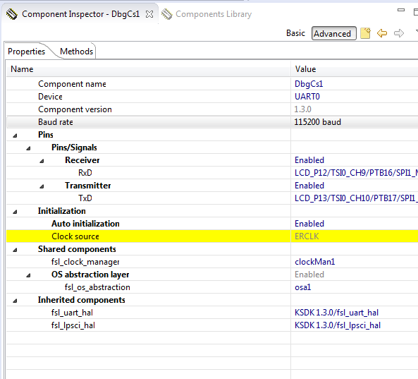

danielecortella
Contributor V
Hello Alice,
sorry for the delay in the response but i had work on other project. Yes
you sample is working fine, i have change the clock crystal to 16Mhz and
use the fsl_debug instead the uart library. The problem born when you
select the clock source of the fsl_debug. If i select the autoselect
all work , but if i select
it crush. There is a bag ....
I use the ERCLK because i have a system that can go in low power
reducing the frequency, using the external clock (16Mhz) directly for
clock the system i can turn off the PLL and FLL.
Attached the sample with external cystal set to 16Mhz and the fsl_debug,
if you try the two setting in one case work, in the other not.
*OPTOI GROUP *
Technical Dept.
Daniele Cortellazzi
OPTOELETTRONICA ITALIA S.r.l.
Via Vienna, 8
I-38121 Gardolo (TN) ITALY
Phone 0039 0461 991121
Fax 0039 0461 990164
[email protected]
www.optoi.com
36,252 Views

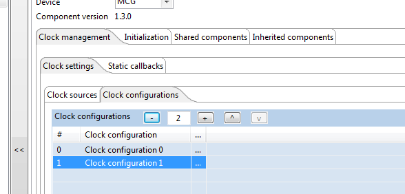

Hello Daniele,
The Clock cfg0 is FEI, so we can not use the ERCLK as the clock source
of UART0. In the CFG1 PEE mode , we can use it , so you can configure the
fsl_debug_console component as this :
And in the code , please add
Pay attention that , my project is from PEE mode to FEI mode , so when it change to FEI mode,
configure the UART clock source as "kClockLpsciSrcPllFllSel ".
Hope it helps
Alice

danielecortella
Contributor V
the software remain in the infinite loop and can't exit, so my firmware is locked there. As visible in the image i see that the SendDataPolling is called by the debug_putc() but i can't reconstruct all the way. I can't see where the debug_putc is called so to debug the code, for do this i have to increase the number of nested function visible in kds.
