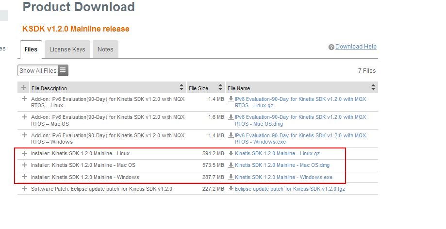

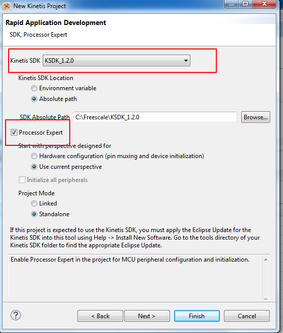

Hello Ivo,
Yes, the Processor Expert doesn't support the KV4 device.
While the KSDK1.2 support it , after you install the KSDK1.2 into the kds ,
it can create one project with  PE:

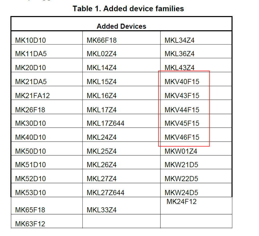

From the release note of KSDK1.2 , we can see it support this chips , you can check whether
includes your chip :
You can download the KSDK1.2 at here : https://nxp.flexnetoperations.com/control/frse/download?agree=Accept&element=6319507
Hope it helps.
