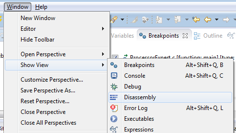

I am wondering how to enable the disassembly view while debugging code running on a FRDM-K64F.
I am new to the whole KDS environment, but I followed all the instructions for project generation provided by the "get started" tutorial.
I am using KDS 3.0 and KSDK 1.2 and the board has the mbed openSDA2.0.
1,786 Views
BlackNight
Use menu Window > Show View > Disassembly:
which gives you

axelacosta
Hi Erich,
Well the disassembly window was there but it was empty.
Apparently closing the window and reopening it seemed to work.
Is this a known bug?
1,786 Views
BlackNight
Hi Axel,
yes, this is a known problem.
Erich
