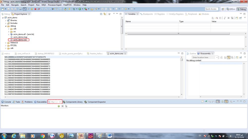

Hi for all
I use KDS v3.2.0 to program KV46f150m kit to impelement speed control of 3-phase induction motor,when reach step debug (no error or warnning), the console window in below display  (Initializing. Target has been RESET and is active. Preset breakpoint encountered.) can any one help me to know all steps(video) to download code into kit.

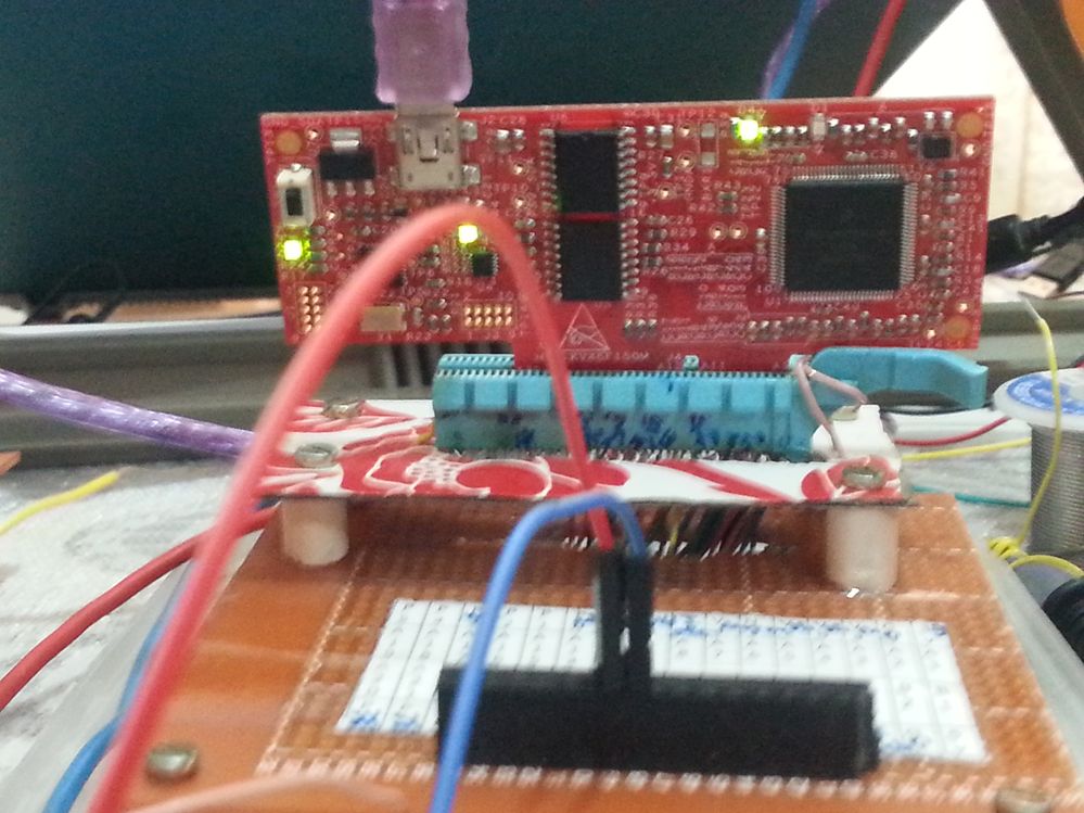

abdullahsahib
Hi Alice

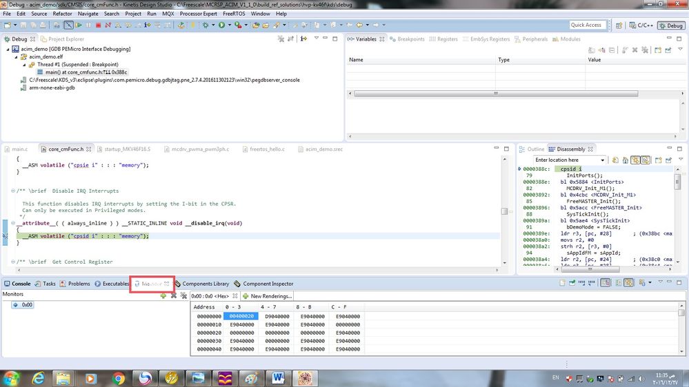

I use MK46F150M kit to control power board(assembeled) as shown below, I used OpenSDA -PNE for download code and LED donot blinke when do steps (step over)
Best Regard
Abdullah

Hi Abdullah,
From your screenshot i'm sure you have download your project into your chip.
And if you use a simple LED project , it not work well , i think you can debug and check your code .
Also check whether the related register have right data .
You do not need emulator , just use the OpenSDA port(J2) .

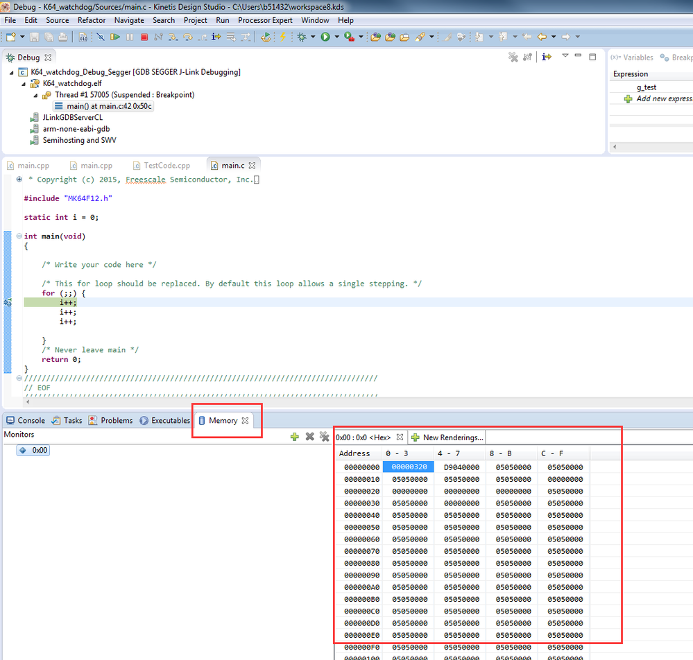

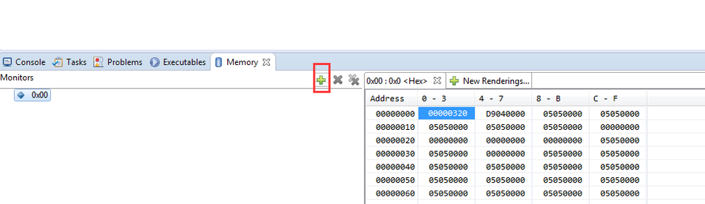

Hello Abdullah,
- About the memory , you need add the memory address you want to check :
- If the LED work well , the project have flashed well.
-What about your board , a demo board ? If yes, please tell me the board name.
If you download  the project by OpenSDA, you can also debug without emulator.
If not, the board is created by yourself , which debugger can used is base on you .
- The step over button is
when you want debug step by step, please click step over, not RUN.
Alice

abdullahsahib
Hi Alice
I am great thank for you, the projects are (MCRSP_ACIM_V1_1_0 & MCRSP_PMSM_V1.1.2) ,the LED demo was work correctly, when do steps according advise no data in memory window as shown in attach.
Best Regard
Abdullah

harshpatel
Hello Abdullah
you have loaded code so think step may correct. I have attached steps to load code using J-link for your reference.
well we have many time faced such type of issue in our boards. try following things:
1] can you verify your project linker file?
-  Following values should be like this.
m_interrupts (RX) : ORIGIN = 0x00000000,
m_flash_config (RX) : ORIGIN = 0x00000400,
m_text (RX) : ORIGIN = 0x00000410,
- Check image Kl46_4 for reference.
2] If Linker files is as suggested then check controller reset pin.
Let me know if any..

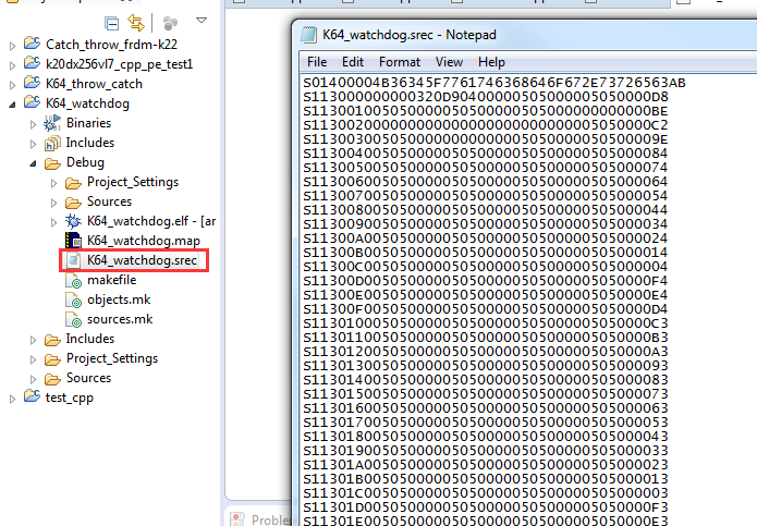

Hello abdullah,
- Does our project is a demo project ?
If you can't be sure the project is right,  i recommend you first download a simple
project to have a try , for example a hello world or a LED demo .
- For check whether it download to chip , there are many methods, the directly way is
check the memory , compare the data with S19 files.
In fact , the easiest way is after download the project, check whether the arrows is enter into the main()
function, mostly , if yes, the project have download into chip .
Hope it helps
ALice

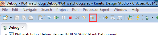

Hello abdullah,
You have download your project into your board correctly, i think there is no error with your steps to download project.
Does it can not run well ?  You can first step one by one to debug through the Step Over(0r F6):
And also you can click the Suspend to check where it shop .
Alice
