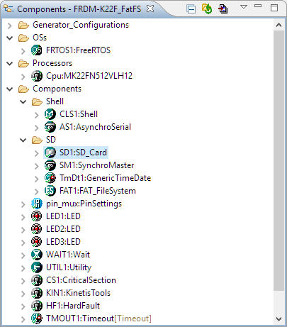

BlackNight
Hi Vitor,
I'm using FatFS with the FRDM-K22F in normal SPI mode and Processor Expert, see https://mcuoneclipse.com/2015/10/07/added-micro-sd-card-socket-to-frdm-k22f/ .
The project is available on GitHub (mcuoneclipse/Examples/KDS/FRDM-K22F/FRDM-K22F_FatFS at master · ErichStyger/mcuoneclipse · GitHub ), but I have attached it for your convenience here as well. Note that the project is using open source Processor Expert from SourceForge (see https://mcuoneclipse.com/2014/10/21/mcuoneclipse-releases-on-sourceforge/  and McuOnEclipse - Browse /PEx Components at SourceForge.net ).

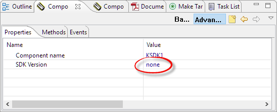

BlackNight
Hi Vitor,
No, it is not using the Kinetis SDK, as the version is set to 'none':
That component is only there to make the bridge for either 'none', SDK v1.3 or SDK v2.0 and to provide the necessary wrappers.
As you should see with the example, you do not need to use the Synchromaster methods directly: simply use the FatFS functions.
