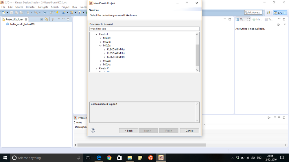

I've developed custom board having KL27 MCU.
But can't find the option for this MCU while creating new project. Please tell me how to add support for KL27 on KDS3.2?

Hello Punit,
What about the part number of your chip?
- If the below screenshot includes it , please install the KSDKv1.3, then you can choose it.
Please download the KSDKv1.3 at here :
Software Development Kit for Kinetis MCUs|NXP
Please download the Kinetis SDK(REV 1.x) :
Then refer to "KDS_Users_Guide.pdf" ->4.2 Installing Kinetis SDK into KDS .
- if the screenshot haven't your chip , please tell me the part number .
Hope it helps

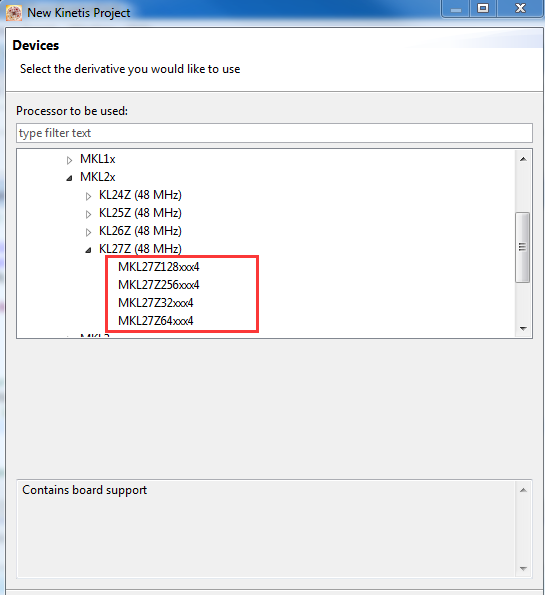

Hello Punit,
Please uninstall it , then install it again. Pay attention that , download and install the latest version .
For i have uninstall most of the update on my KDS, while it also can create project about KL27 , so
i think it is include when install KDSv3.2 .
