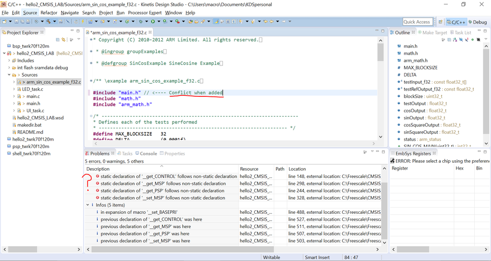

Good Evening!
Currently developing on the TWR-K70F120M kit, developing on IDE, KDS 3.2.
I have been having extreme difficulty getting CMSIS library examples to run on MQX 4.2. I have completed the MQX 20 technical sessions and decided to make a new project to test out CMSIS and the variety of examples provided.
Initially, I tried using KSDK1.x, KSDK2.x and realised they were incompatible. I also downloaded CMSIS v4.2, v5.
I am mainly interested in using the CMSIS-DSP library, I have followed the guides word for word:
http://cache.freescale.com/files/microcontrollers/doc/app_note/AN4489.pdf
AND
Tutorial: Using the ARM CMSIS Library | MCU on Eclipse
My steps:
1) Clone Hello2 example from MQX
2) Included Libraries from CMSIS
My understanding is there is a conflict in function names but I am just unsure where to go from here.
However, the errors I am getting are in the screenshot (See Attached Document).
Kindest regards,
************************CONSOLE LOG**********************************Problems with CMSIS.pngproblems with cmsis scrolled.PNG

arm-none-eabi-gcc -mcpu=cortex-m4 -mthumb -mfloat-abi=hard -mfpu=fpv4-sp-d16 -O0 -fmessage-length=0 -fsigned-char -ffunction-sections -fdata-sections -Wall -Wno-missing-braces -g3 -gdwarf-2 -gstrict-dwarf -gstrict-dwarf -gstrict-dwarf -nostdinc -D_AEABI_LC_CTYPE=C -D__FPU_PRESENT -D__STRICT_ANSI__=1 -D_DEBUG=1 "-IC:\\Freescale\\CMSIS_5-develop\\CMSIS/Core/Include" "-IC:\\Freescale\\CMSIS_5-develop\\CMSIS/DSP/Include" "-IC:\\Freescale\\Freescale_MQX_4_2\\lib\\twrk70f120m.kds\\debug" "-IC:\\Freescale\\Freescale_MQX_4_2\\lib\\twrk70f120m.kds\\debug\\bsp" "-IC:\\Freescale\\Freescale_MQX_4_2\\lib\\twrk70f120m.kds\\debug\\bsp\\Generated_Code" "-IC:\\Freescale\\Freescale_MQX_4_2\\lib\\twrk70f120m.kds\\debug\\psp" "-IC:\\Freescale\\Freescale_MQX_4_2\\lib\\twrk70f120m.kds\\debug\\shell" "-IC:\\Freescale\\KDS_v3\\eclipse\\../toolchain/lib/gcc/arm-none-eabi/4.8.4/include" "-IC:\\Freescale\\KDS_v3\\eclipse\\../toolchain/lib/gcc/arm-none-eabi/4.8.4/include-fixed" "-IC:\\Freescale\\KDS_v3\\eclipse\\../toolchain/arm-none-eabi/include" -std=gnu99 -D__VFPV4__=1 -D_DEBUG=1 -c -fmessage-length=0 -c -o "Sources\\arm_sin_cos_example_f32.o" "..\\Sources\\arm_sin_cos_example_f32.c"
In file included from C:\Freescale\CMSIS_5-develop\CMSIS/Core/Include/cmsis_compiler.h:48:0,
from C:\Freescale\CMSIS_5-develop\CMSIS/Core/Include/core_cm4.h:162,
from C:\Freescale\CMSIS_5-develop\CMSIS/DSP/Include/arm_math.h:328,
from ..\Sources\arm_sin_cos_example_f32.c:86:
C:\Freescale\CMSIS_5-develop\CMSIS/Core/Include/cmsis_gcc.h:148:57: error: static declaration of '__get_CONTROL' follows non-static declaration
__attribute__((always_inline)) __STATIC_INLINE uint32_t __get_CONTROL(void)
In file included from C:\Freescale\Freescale_MQX_4_2\lib\twrk70f120m.kds\debug\psp/psp_cpu.h:49:0,
from C:\Freescale\Freescale_MQX_4_2\lib\twrk70f120m.kds\debug\bsp/mqx.h:1236,
from ..\Sources\main.h:11,
from ..\Sources\arm_sin_cos_example_f32.c:84:
C:\Freescale\Freescale_MQX_4_2\lib\twrk70f120m.kds\debug\psp/cortex.h:527:25: note: previous declaration of '__get_CONTROL' was here
extern uint32_t __get_CONTROL(void);
C:\Freescale\CMSIS_5-develop\CMSIS/Core/Include/cmsis_gcc.h:244:57: error: static declaration of '__get_PSP' follows non-static declaration
__attribute__((always_inline)) __STATIC_INLINE uint32_t __get_PSP(void)
C:\Freescale\Freescale_MQX_4_2\lib\twrk70f120m.kds\debug\psp/cortex.h:507:25: note: previous declaration of '__get_PSP' was here
extern uint32_t __get_PSP(void);
C:\Freescale\CMSIS_5-develop\CMSIS/Core/Include/cmsis_gcc.h:298:57: error: static declaration of '__get_MSP' follows non-static declaration
__attribute__((always_inline)) __STATIC_INLINE uint32_t __get_MSP(void)
C:\Freescale\Freescale_MQX_4_2\lib\twrk70f120m.kds\debug\psp/cortex.h:511:25: note: previous declaration of '__get_MSP' was here
extern uint32_t __get_MSP(void);
C:\Freescale\CMSIS_5-develop\CMSIS/Core/Include/cmsis_gcc.h:328:53: error: static declaration of '__set_MSP' follows non-static declaration
__attribute__((always_inline)) __STATIC_INLINE void __set_MSP(uint32_t topOfMainStack)
C:\Freescale\Freescale_MQX_4_2\lib\twrk70f120m.kds\debug\psp/cortex.h:503:25: note: previous declaration of '__set_MSP' was here
extern void __set_MSP(uint32_t);
In file included from C:\Freescale\Freescale_MQX_4_2\lib\twrk70f120m.kds\debug\psp/psp_comp.h:34:0,
from C:\Freescale\Freescale_MQX_4_2\lib\twrk70f120m.kds\debug\bsp/mqx.h:90,
C:\Freescale\Freescale_MQX_4_2\lib\twrk70f120m.kds\debug\psp/comp.h:39:32: error: expected identifier or '(' before '__asm'
#define __set_BASEPRI(basePri) __asm volatile ("msr BASEPRI, %0" : : "r" (basePri))
C:\Freescale\CMSIS_5-develop\CMSIS/Core/Include/cmsis_gcc.h:488:53: note: in expansion of macro '__set_BASEPRI'
__attribute__((always_inline)) __STATIC_INLINE void __set_BASEPRI(uint32_t basePri)

xiulizhang
Hello Marco,
Maybe you can move the include file "arm_math.h" before "main.h".
Best Regards

takmingmarcopan
Sorry, that link is not exactly relevant. I'm not having trouble "linking" it per say but actually getting conflicting errors (Which I think are function definitions sharing the same name with MQX).
