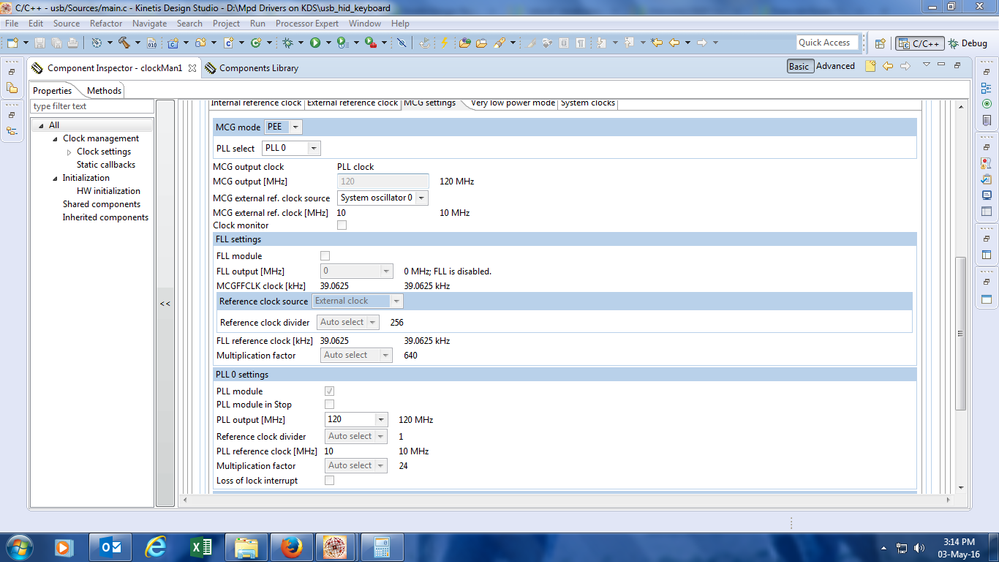

I have created a project for usb hid host For K66 Using K65 example ,but i have used processor expert and configured the  CPU external crystal is of 10 Mhz , PLL output is 120 (Mhz) as shown below image. I have only configured the CPU by PEX148470_148470.PNGimg1.PNG

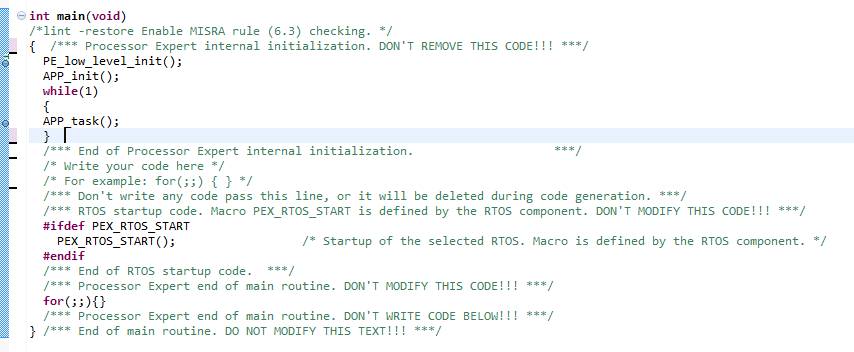

Rest of the code is from K65 example( path: \KSDK_1.3.0\examples\twrk65f180m\demo_apps\usb\host\hid\keyboard) .
Given below is my main function. App_init() is working ok 148471_148471.PNGimg2.PNG
Timeout is always occuringin the function given below( timeout value is 0 which is being passed ), this fuction is called by APP_task.
if ((((!waitAll) && (*setFlags))) || (*setFlags == flagsToWait)) will never go true. what can be the reason for this .

Hello Rimi,
USB Host examples are waiting for any device to be connected, usually, these events are managed by signaling OSA's events (OSA_EventWait, OSA_EventSet), so, in this case, if you are getting a timeout error, then, the proper event is not being signalled.
Which event are you waiting for? Where this OSA_EventWait function is called?
