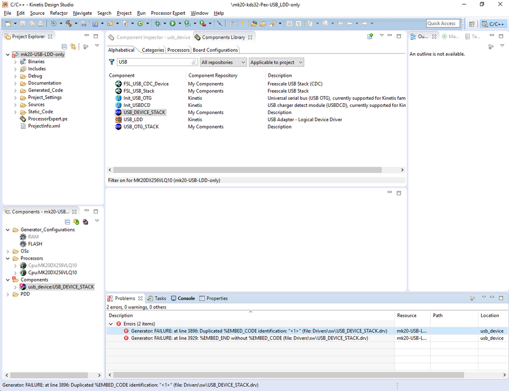

I have experienced the error when generating the code from Processor expert.
KDS 3.2, USB_STACK 4.1.1. No RTOS.
The project was created with PEx only. no any other function has been attached yet. Just configuring the bus clock to 48Mhz, so the clock to USB module is at 48Mhz.
There was no static error reported from Processor Expert. The error is shown up only after generating the code.
Could someone help to figure out how to resolve this issue?

Hello Tony,
There is a workaround , please  search the file of "USB_DEVICE_STACK.drv" ,
on my side the path is   C:\Users\Alice\MyComponents\Drivers\sw
please replace it use my attachment . Then re-open the KDS, build , the error will disappeared .

Hi Alex,
Thank you for the answer.
I have tried the similar solution before, it did not now.
I would like try the file you mentioned. Have you attached it here? I could not find your attachment.
