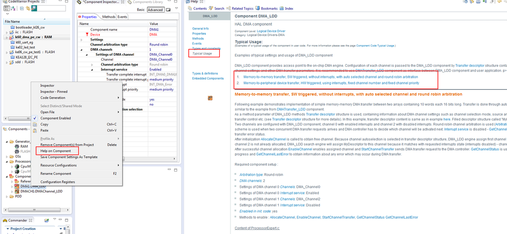

Hello Benjamin,
-  About the PE-CW demo code , i have not the GPIO trigger DMA, while there is HW trigger DMA , it use DAC , i think the configure of the DMA
is the same , so you can refer to .   After you add the component "DMA_LDD" or "DMAChannel_ldd" , then right click the component , select the
"help on component " , in the Typical Usage , you can find the demo :
Does this can help you ?
